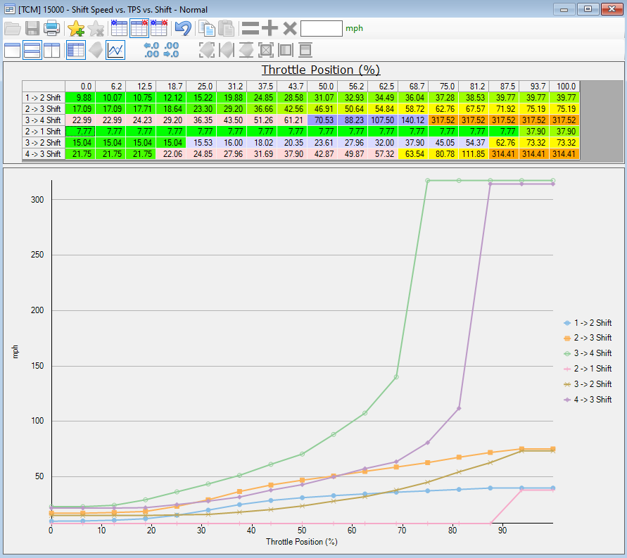

Looking at '09 PPV tune vs '08 sub/yukon certainly tweaks..
Don't know if there was a different OS for 07-08 vs 09?
09 ppv shift schedule
08 yukon 5.3 shift schedule (closest comparable file, same gear ratio, same engine)
Don't have a '10-'13 ppv tune to look at..
'15+ no real changes that iirc..
