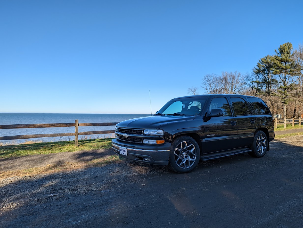

Hey all,
Anyone running one of these on a lowered Tahoe? They only show raised applications. I would like to re-center my axle.

Are you in or near PA? I am over by Philthy suburbs. Your Tahoe looks sweet. Welcome.
