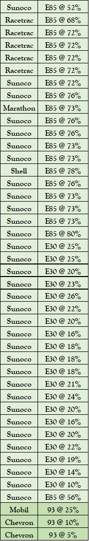

I live in Michigan, come winter E85 can drop as low as 61% ethanol. I've read about using E85 test kits (glass vial) is there an easier way to confirm the ethanol percentage?
Is there a website that lists when the E85 has the ethanol percentage lowered?
See I read that winter blend E85 is not supposed to drop lower than 71%! That's the problem with it, the numbers are not consistent. I don't know, the guy who blends at the Sunoco I go to for E30 obviously could do a better job of it, or maybe cycle the tank more often, if there is such a thing to keep it mixed? I dunno.

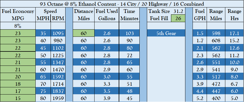

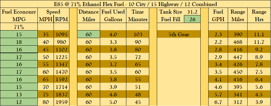

Yes. Soon after the cats were replaced last year we took a day trip down to the keys and the truck averaged 17.01 MPG over 359 miles. There was a bit of stop and go in there too.
These are the MPG numbers from running multiple 2-way averages in each 5 mph increment. Also have numbers for E85 @ 80% and 71%. Not done with E30.
Well, here's one of the E85s:

Wow that's fantastic information. Very cool to see how the MPG drops off as your speed increases. IIRC you fight twice as much air for every 10 mph you go up in speed. Do you have AFM deleted?
