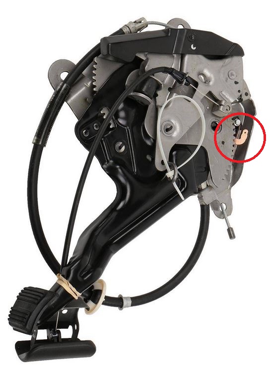

I have a 2001 GMC Yukon and my emergency brake alarm has just recently started staying on. I can't get it off. The e-brake works fine. Doesn't stick. The alarm goes on when I drive and turns off when I stop. How can I stop the alarm from staying on all the time?

Take a look at the parking brake cable assembly (by your left foot, sitting in the driver's seat) and see if there is a wire connected to the copper-colored connector. There should be a wire connected there:
