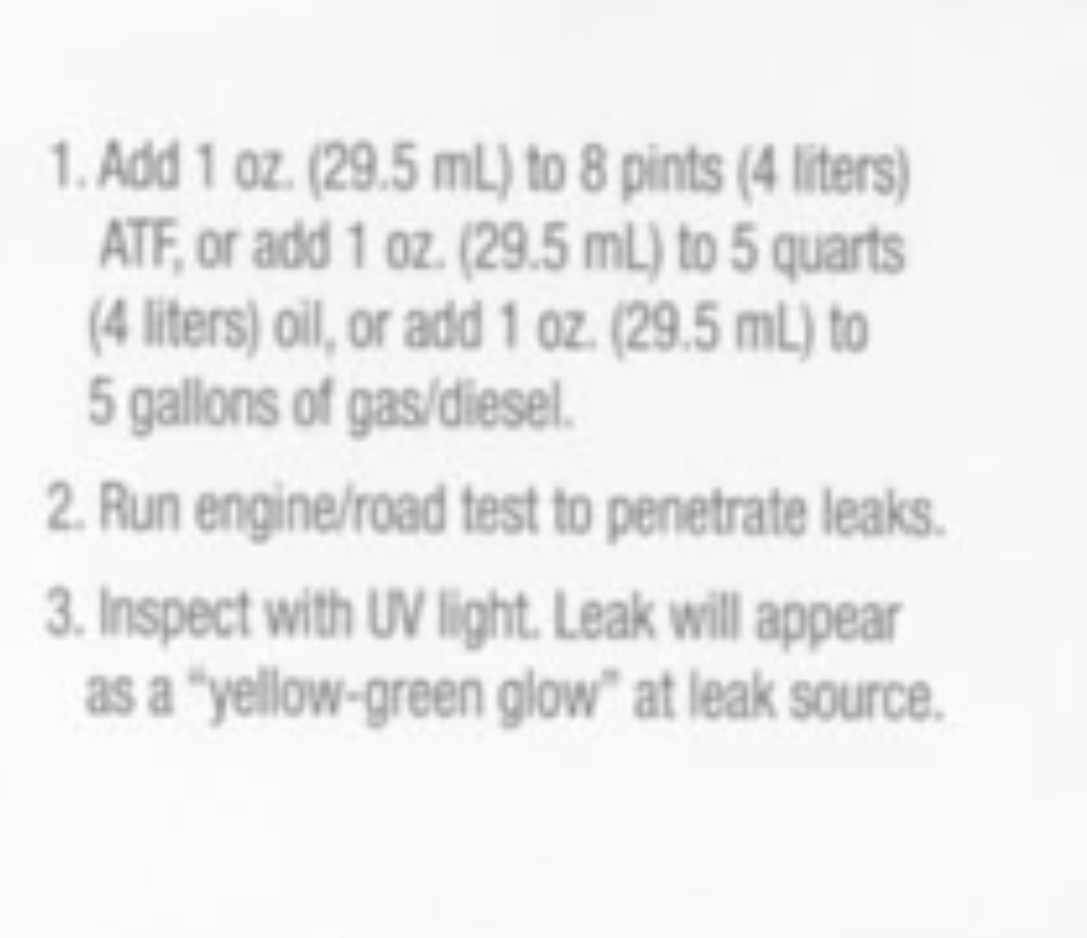

I have 1 more Q..I read that add 1 oz of Dye to 4 L of engine oil..our Yukons taking 7.6L, should I add 2 oz of it for detection or 1 is enough??
Have a look to photo attached
