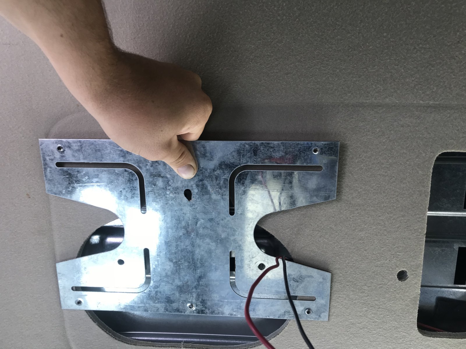

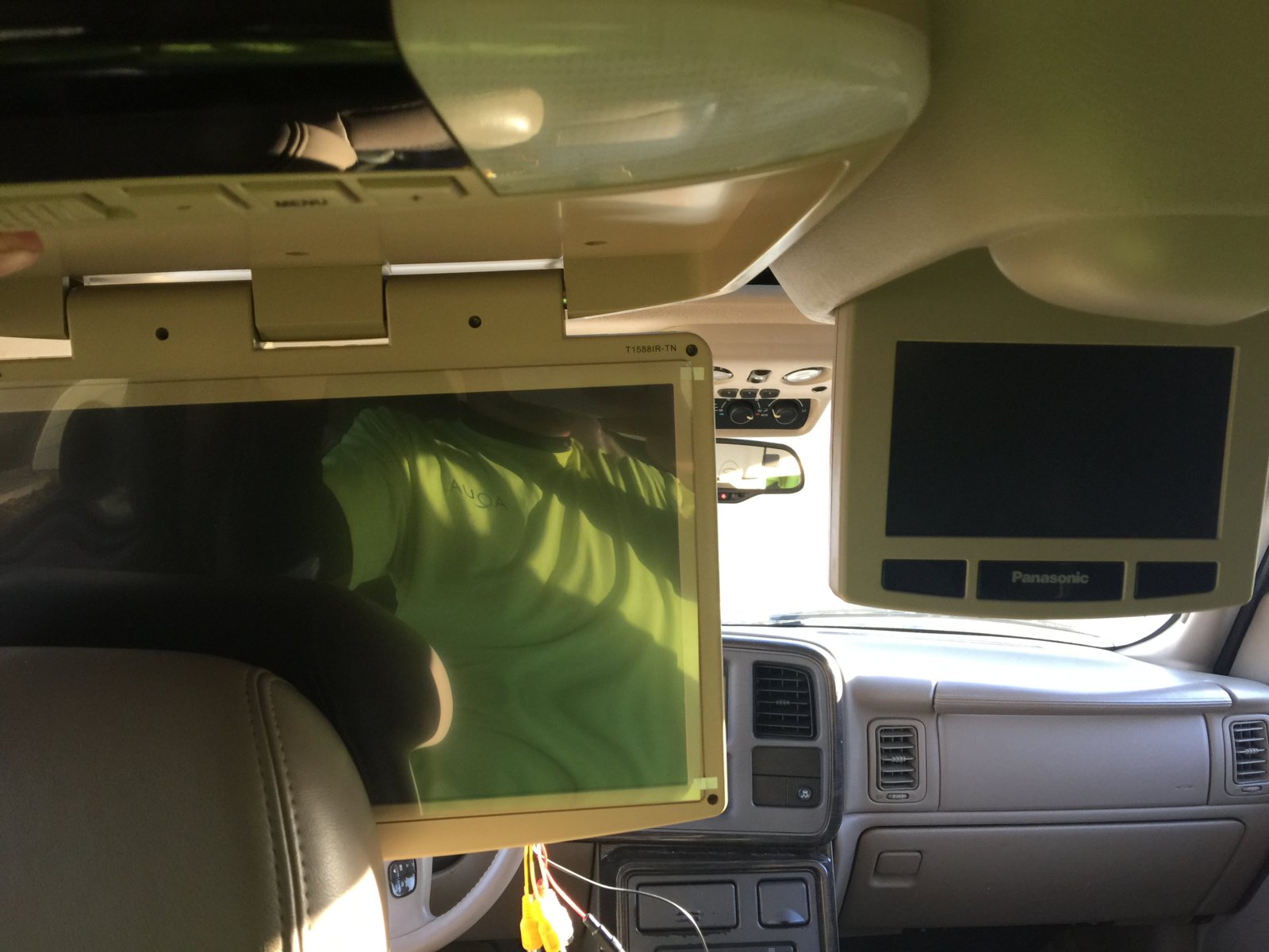

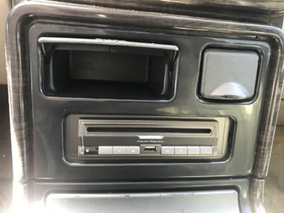

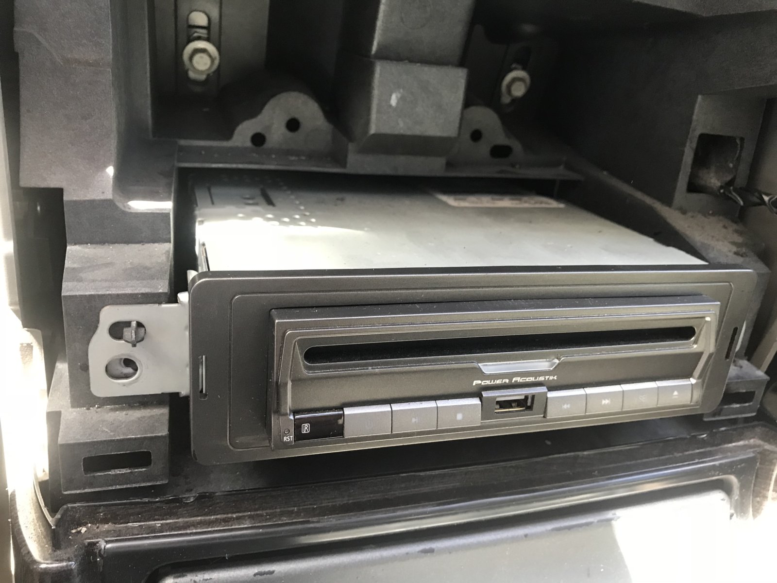

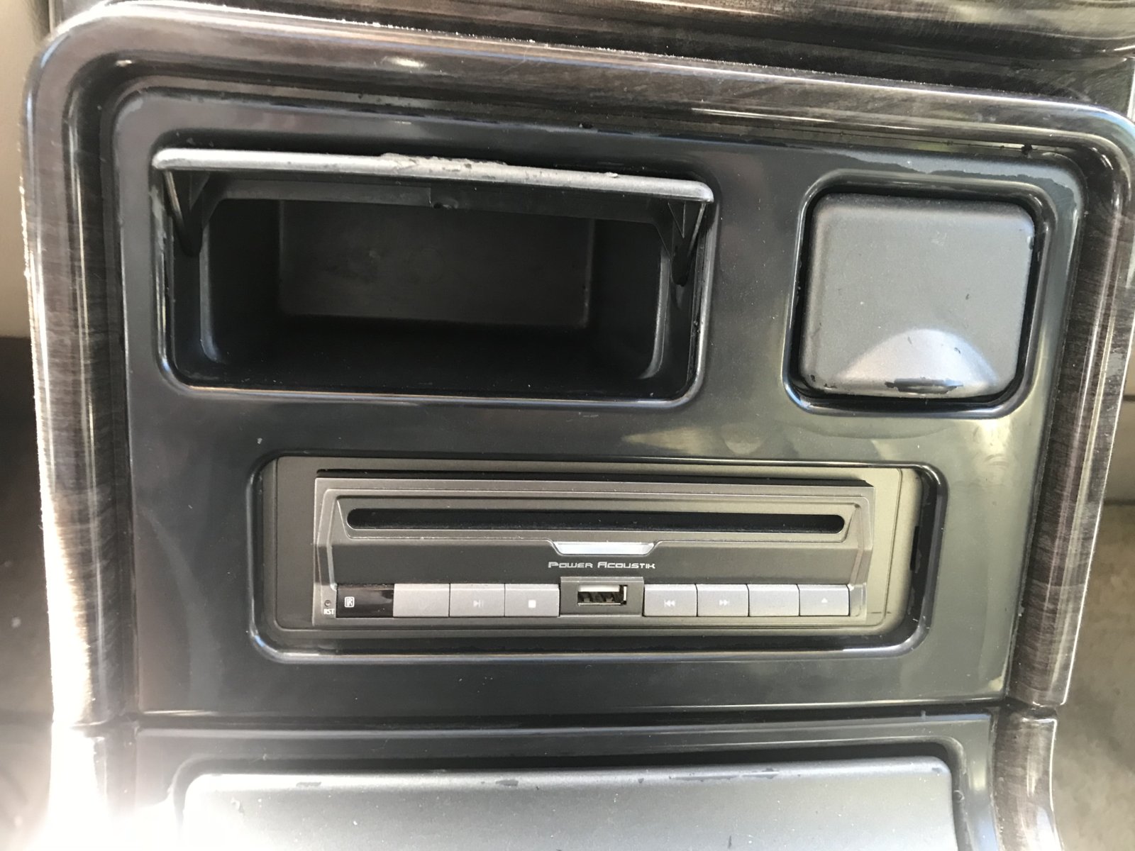

I replaced the factory DVD player with a 15” monitor by Tview. It’s pretty decent quality and a pretty big upgrade. For the DVD part I put in a Power Acoustik DVD player model PADVD390 and ran a set of rca splitters with one set going to the monitor and the other to the indash. I can play the movie through both and listen to it through the speakers or just the monitor with the wireless headphones. Mounting it was pretty easy, I took the mounting plate from the new monitor and lined up the holes on the factory bracket and drilled the holes in the new mounting plate to match and just used the factory hardware.

Not to mention I control all the dvd functions from the front with the DVD player now and that’s much easier than reaching behind me trying to find buttons lol

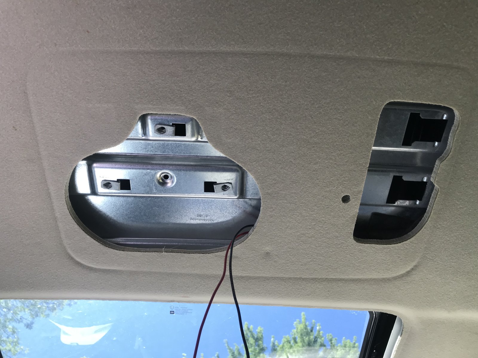

Yes I had the one that went to the side. There will be the smaller hole to the side still visible but because the monitor is so big it will cover the other hole entirely. The only way I know to cover the hole is to redo the headliner and not cut it out. I did take some pics for reference hopefully it helps. I don’t have one of the monitor mounted I removed it to do some other stuff and haven’t put it back in yet.

I forgot to mention, for the dvd drive I gutted the old 6 cd changer and used the housing for the mount. I was able to take it apart and place the DVD player inside of it. I did have to Dremel the back a little bit for the rca cables to go through but it was pretty easy and gave the perfect fit.

You could always make an insert for the hole and cover it with headliner material. Just pop it in the hole. At least you won't have to look at that hole.
