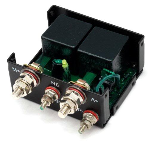

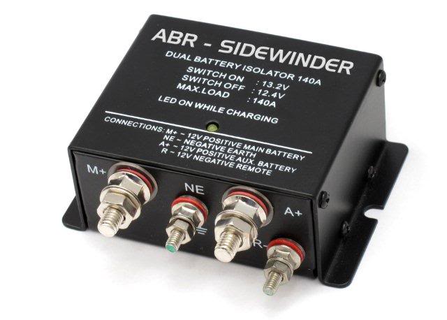

So the plan is to buy this Australian part as you can see (isolator)
What I liked about this is the low voltage and the functions too
More to pictures:

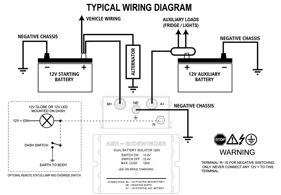

And this the plan I liked for installation:
The questions I have are:
1- do I understand that it will charge it self (the second battery )?
2- what kind of harm are we talking about? (If there is any)
3- If I used this setup iam not going to drain the main battery? (By using the sec battery)
4- can I use continues liad on the second battery and running the car at the same time? (Like e-fan)
What are the benefits out of this setup?

It will do what you are expecting however I would lean more to solid state devices when rated for that much amperage. Also typically to to not fry a battery in hot weather from overcharging the voltage outputs of alternators put on this vehicles will decrease as the surrounding temperature goes up. As a result you may not always reach the 13.2 trigger to close the relays where you live. Nothing to worry about much but keep it in consideration. you should be able to use continous load on both. By design tho if the primary battery circuit drops to 12.4vdc it will cut off the auxiliary battery from the primary. You can still drain the two of them separately of course with out one effecting the other. Please keep your e-fan power supply as the main battery. Never hook primary cooling fans to a secondary source unless redundancy provisions are put into place in case of electrical faults in the secondary system.

You do loose more amps and volts going through that isolator in heat that why they have
Heat sinks on it the solenoid you want have that issue.
