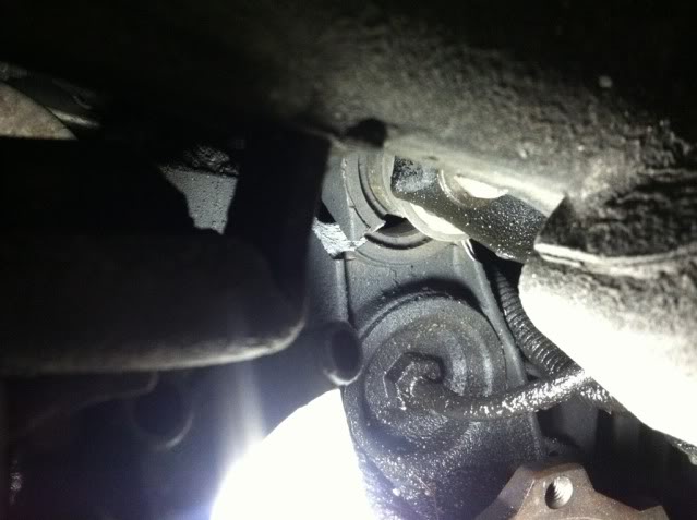

So a long story short I keep breaking my driver side CV axle.. I have replaced the drivers CV axle with a oem one from the local parts store. I put it in and I can drive straight but as soon as I turn either in 2 or 4wd it pops out and breaks on the diff side.. So im not sure what the deal is.. I have put 4 CV axles in so far and everyone pf them pop out and break when I try and turn.. I'm running 2" drop spindles in the front and hd keys.. I also have brought it up to factory height by cranking the keys and then put a new axle in and still no change. Does the same thing pops out right when I turn..Anyone else have this issue???

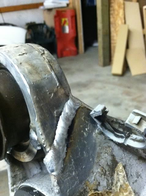

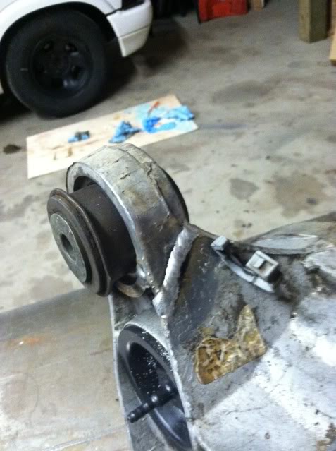

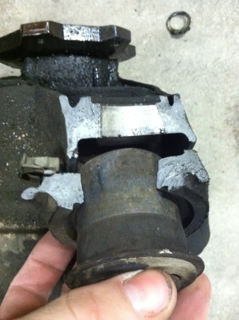

I ended up finding my problem.. Top front diff mount was broke and diff was pushed all the way to the right side causing the driver cv axle to pop out..
All fixed
