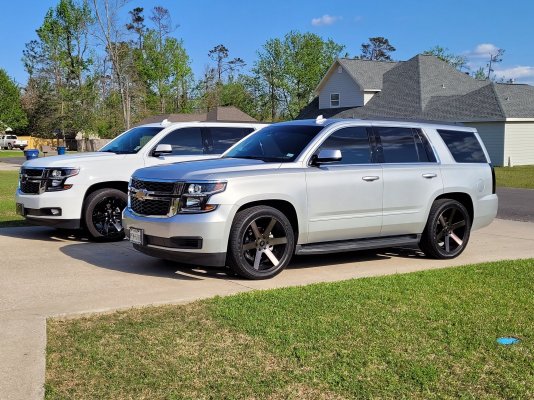

This is a Maxtrac 2" spindle with a bell tech 3" rear coil

i personally dont care for cutting the stops off, i do however shorten the factory bump if the kit does not come with them.
this is the same ride, just a day earlier. originally ordered a 2/4 drop, but the rear maxtrac spring came out to be closer to 5"...so igrab the belltech coils from a local summit racing...and finished at a 2/3 as posted earlier.
