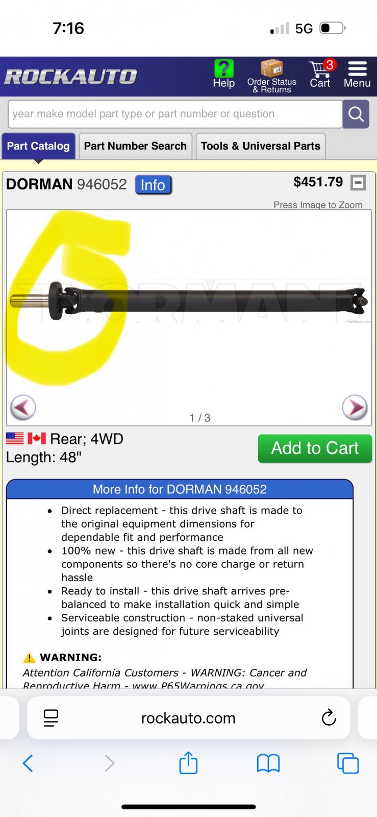

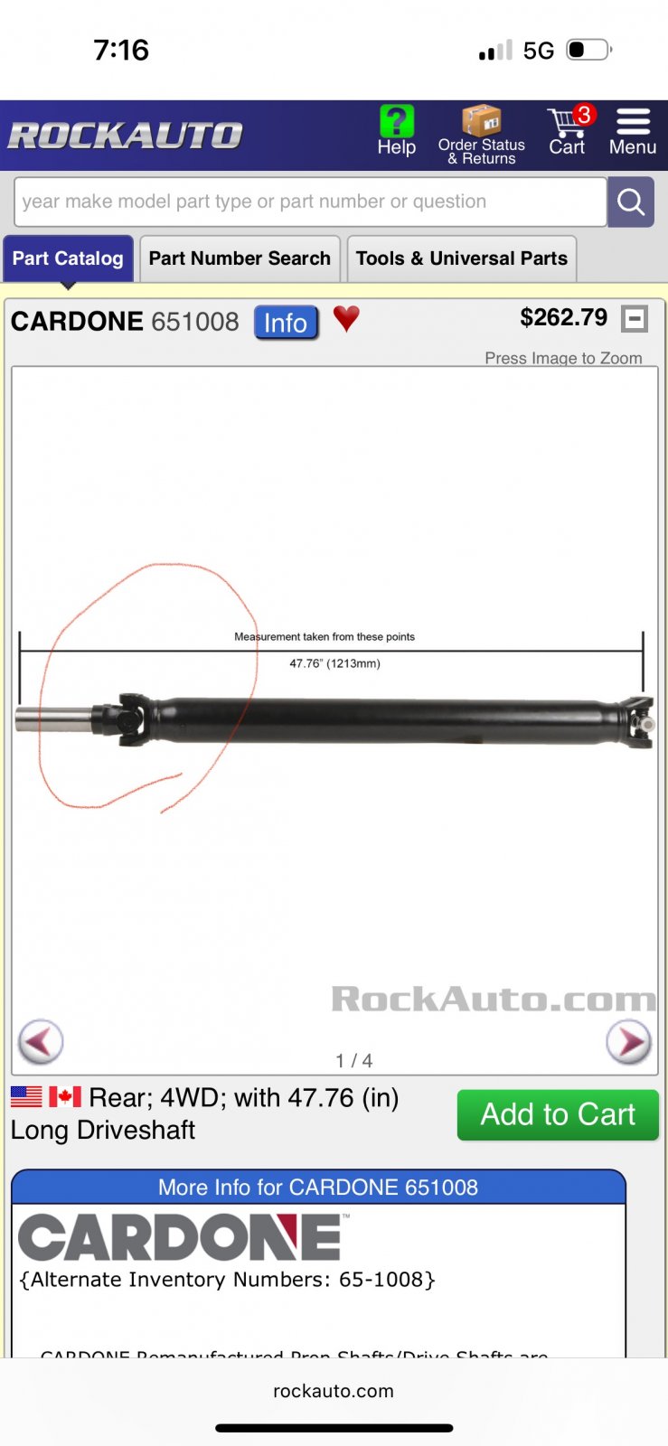

Hey everyone, I’m going to be replacing my driveshaft and found these two on rockauto. Both refer to the same oem part number but the yoke to the transmission appear to be different. Can someone tell me the difference in the two styles? The cardone unit looks identical to my current one.

Different manufacturing methods/parts is what the difference appears to be. Some earlier trucks had that balancer which is shown on the Dorman.
My 2009 looks more like the Cardone.
That’s what I was thinking. I’m going to order the Cardone one to dredging up the drivetrain before the rear end gets rebuilt and a new transmission goes in as well. Still cheaper than a new truck. lol.

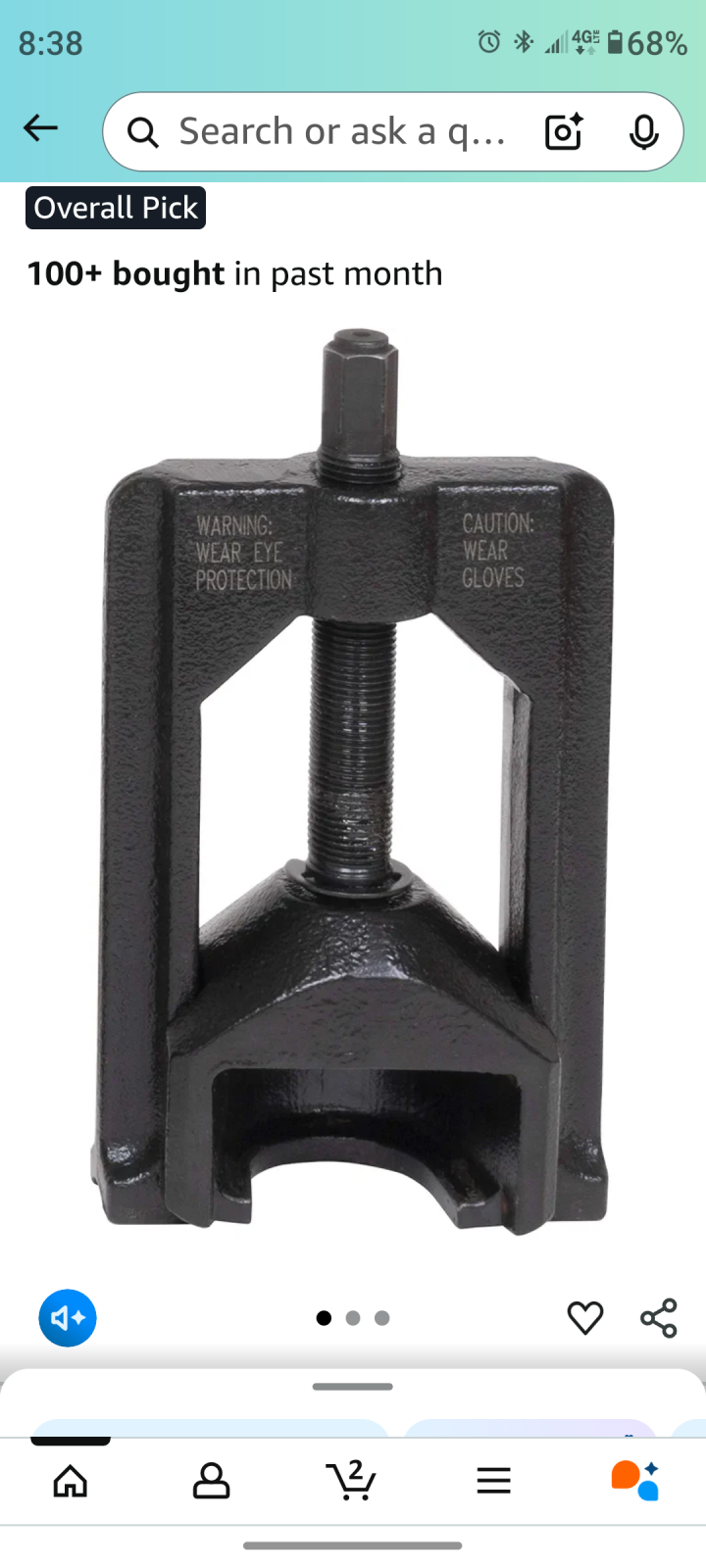

Just look up a u-joint removal tool on Amazon
