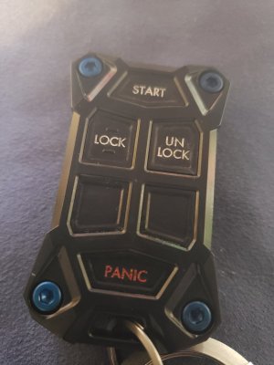

Funny you mentioned that. I've been meaning to get on here and tell people about my experience with Boost auto parts key fobs. https://boostautoparts.com/products/fob?variant=13368373706807
Complete and total headache! I've had nothing but problems with these Boost Auto Parts 2015 retrofit key fobs. Keep in mind that what you see in the picture is a AJT Designs key fob case, the boost auto parts key fob board is inside.
I actually bought two Boost key fobs to use with my AJT Design cases. Thats close to $200 in key fobs that su#k!
I literally have to be right at my door half the time to get them to work. They have horrible range even with brand new lithium batteries. When they do work, there slooooooooow. There is no fast pressing of buttons, its almost like the fobs have a major delay from one signal to the next or the trucks computer cant decipher what its being told....
Ive programmed them over and over again to no avail. The regular fobs work great.
So picture me and the wife walking to the truck, I press "unlock", my door unlocks. I press "unlock" again and nothing...I press "unlock" nothing, I press "lock" to see if Im pressing the wrong dang button and it immediately locks my door. I press "unlock" my door unlocks, I press "unlock" it unlocks my door again without unlocking the other doors. (keep in mind its freaking cold outside, and we have groceries in hand, wife's just standing at her door waiting for me to finally unlock her door) Eventually after about ten tries the doors unlock.....This is my life.
My wife has given up on my fob shooting blanks and now just uses her own fob to open herself.....meanwhile Im left feeling demasculated because my big fob wont get her door unlocked.....
..its not a matter of the button not being pressed inside the case, I can feel the full depression of the button being pressed on the internal board, so its not a mater of the AJT case not fitting inline with the Boost board.

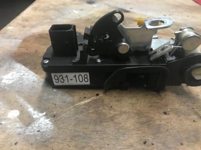

These door lock actuators seem to be a common issue I just replaced drivers side rear on a 2009 Tahoe and it already had an aftermarket replacement in it. (used truck I bought about 15 mths ago) It is an easy job no big deal. I bought the elcheapo replacement for 34 dollars it looks like an OEM type part is around 105 dollars.
Saw that some guys were replacing the mechanism's internal electric motor but the replacement was 35 dollars and involved a bunch of tedious extra work on the original part. Here is a pic of the old part it was stamped made in Taiwan new part looks identical but is stamped made in china Haha. IMG_9307.jpg
