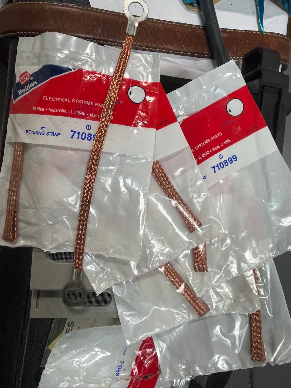

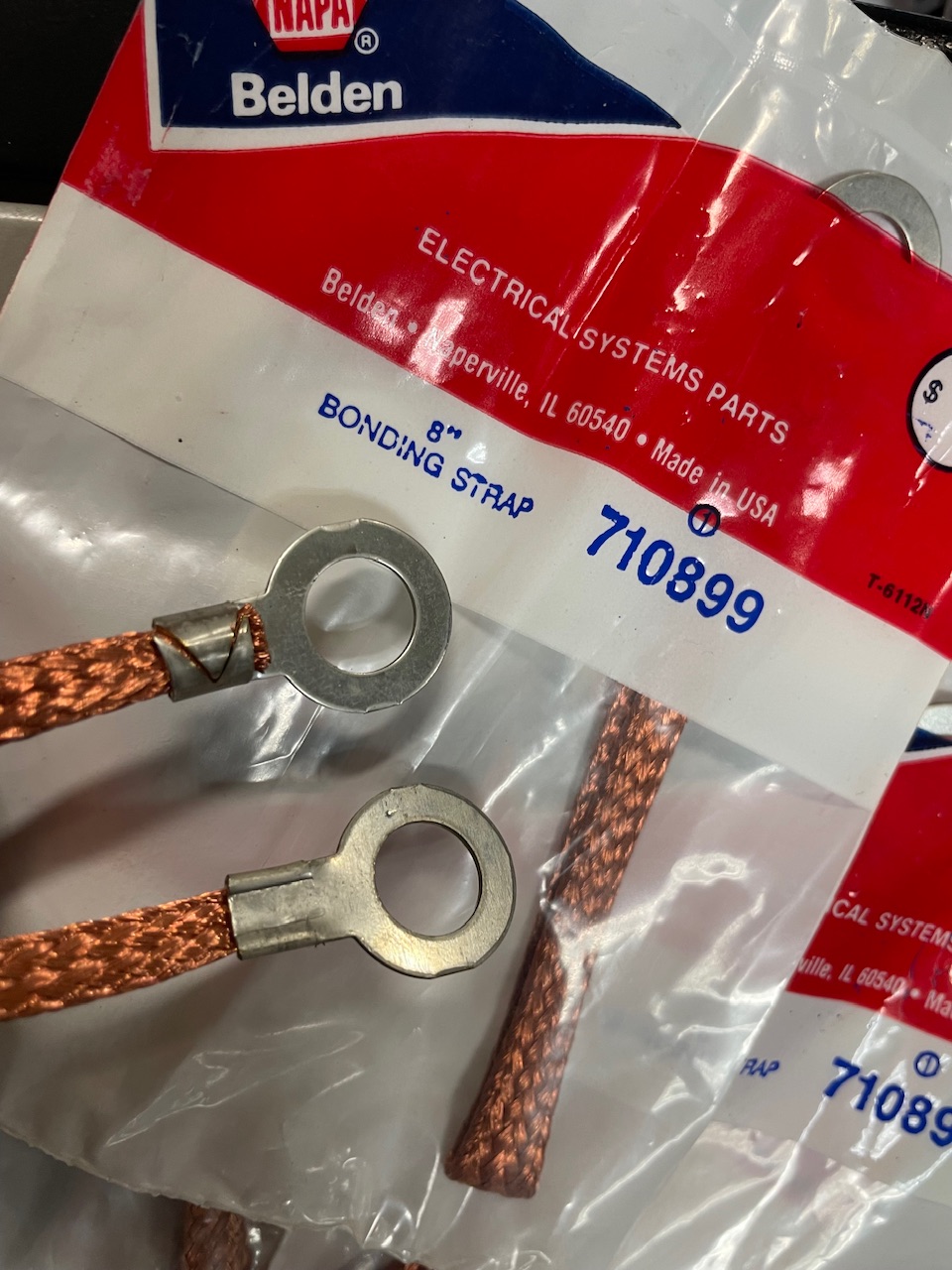

Got these 8" Napa 710899 straps on ebay (1 auction, sorry you'll have to find another seller).
They look like a better braid and crimp than the amazon stuff..
But not as nice looking as the 9" GM straps. (AI-10-0021REVA Ground Strap - which I can't find)
