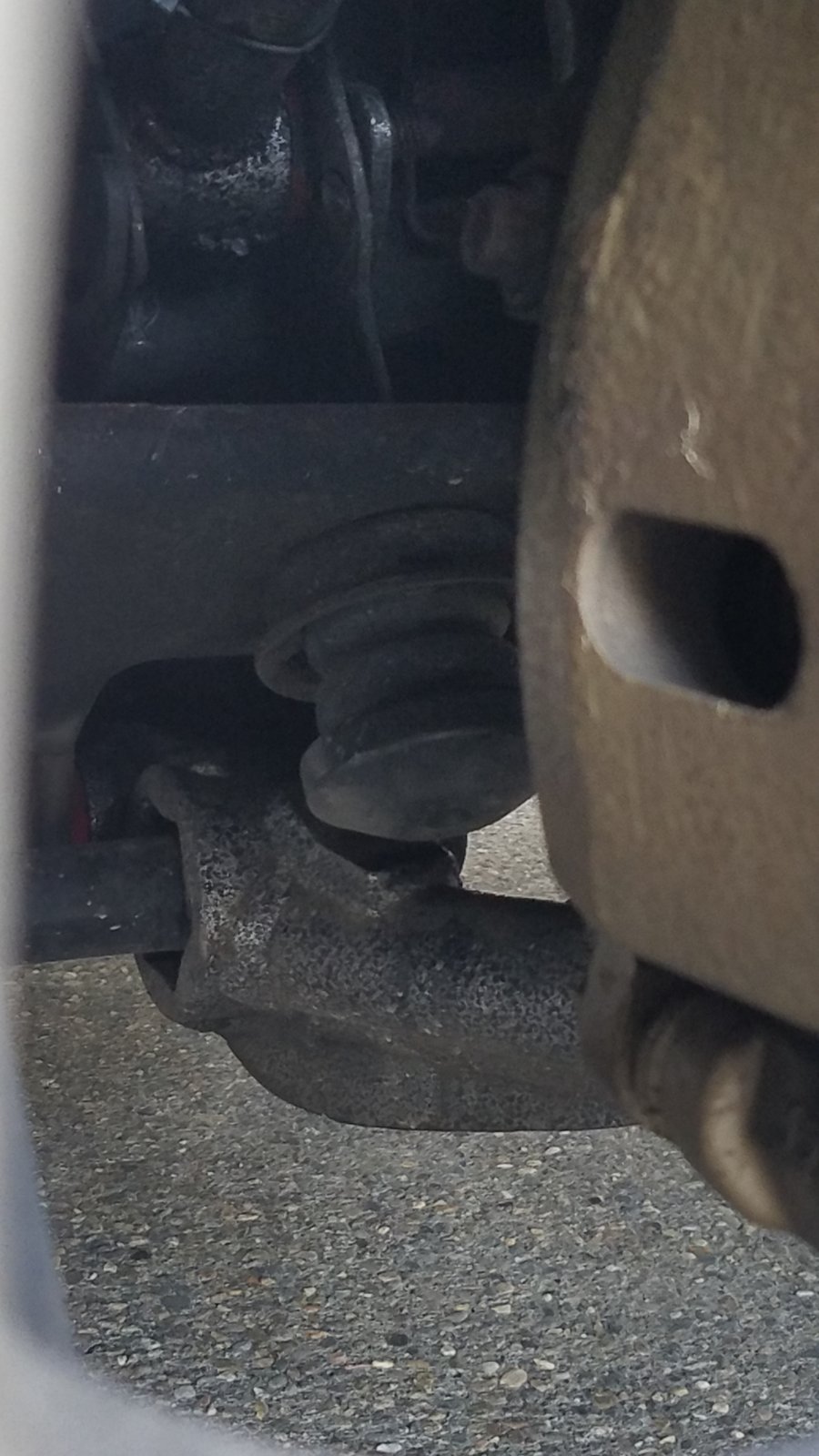

My memory was incorrect. They are there.

Those look like djm lowers.I had the same question and Tony said to NOT use the jounce stops..My truck doesn't drive well at all..

I have the djm lcas and the stoppers are still installed as you can see. I have no issues and a smooth ride..

That spot looks to me to be more bracing than a place for the jounce to hit..The angle isnt right either.
