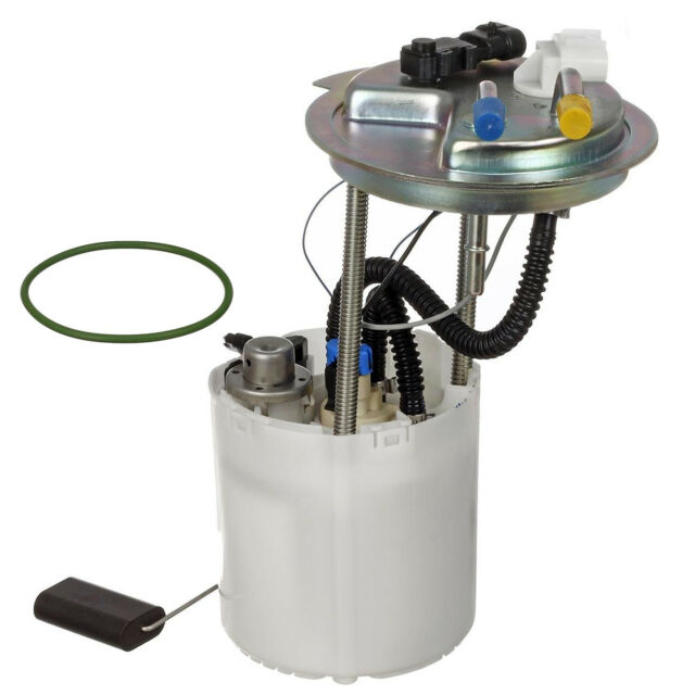

See the white plastic in this example photo of the pump assembly? That is the tub that surrounds the pump with fuel. Even after the tank drops below the top of the tub, it will still be full of fuel until near the end.

K and C chassis fuel tanks have a sump area that the fuel pump module sits down in. If you have a 20+ gal tank then you are going to have roughly 5 gals+ of fuel in the tank at 1/4 tank which is more than enough to cover the fuel pump sump area. That sump area might hold 2 gals if its lucky so there is plenty of fuel sitting above that area. As far as dirt or sediment, well that is the fuel pump sock filter's responsibility. No matter what the level in the tank all sediment and dirt is being drawn down toward fuel pump as it is sucking fuel out of the sump area. That fuel pump sock (filter) has to then do its job and prevent that crap from getting into the fuel pump.
