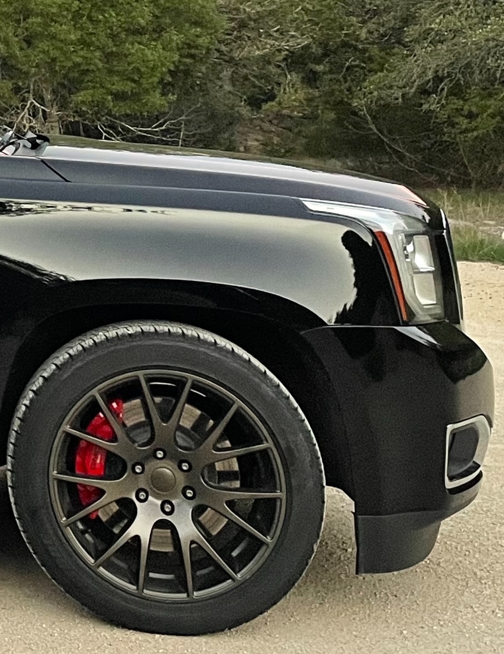

The stock brakes work ok. But if you want your yukon/tahoe to stop like a small car, get the brake brembo brake kit. I did. The difference is night and day.
