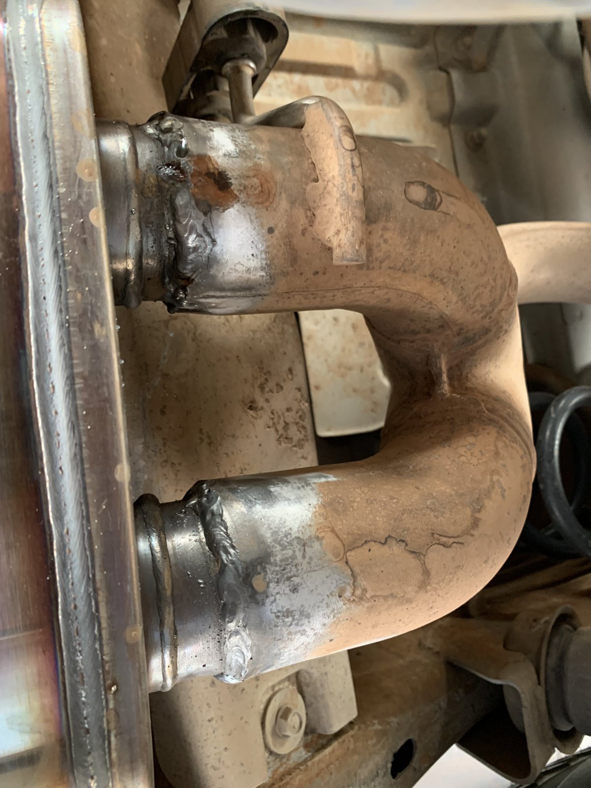

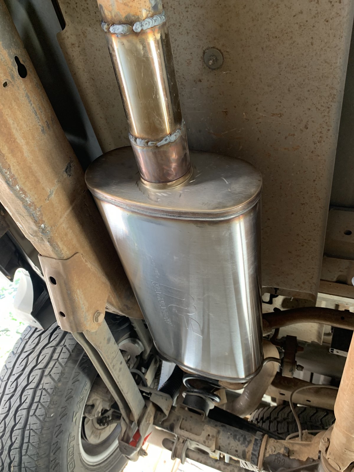

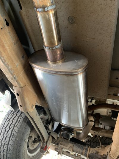

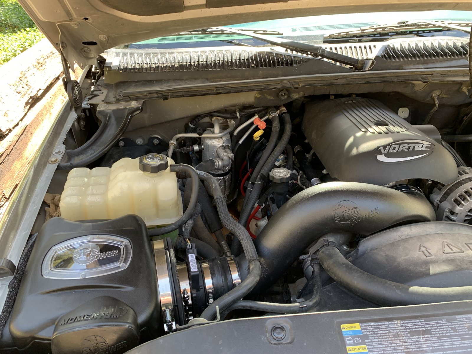

In addition to Blackbear tune I also replaced the stock muffler with a magnaflow 12588 which is nearly a direct swap (needs to be welded). Also added a AFE 54-74101 intake.

Muffler and intake pics attached
