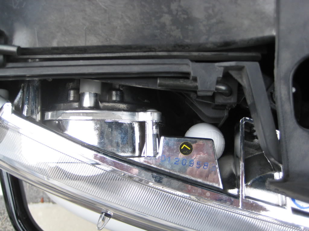

Thank you. I would really like to see what you did. For the moment I silicone some ping pong balls in. It looks so bush league but it is working for the moment.

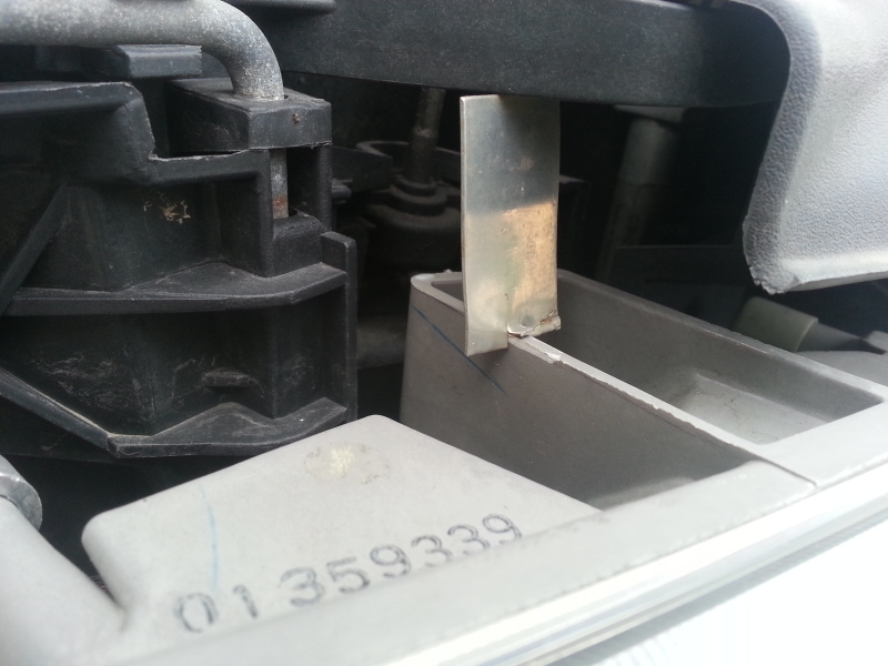

Here was my fix for the depo shake. I took a 1 1/4" piece of this metal banding that I had found and cut a little notch out on the bottom. I then wedged it in between the two places. It's been there for at least 4 yrs with no problems. Only issue might be whether it's pushing the lights a little lower than what they should be. One of these days I wanted to go and make sure my headlights were at the right angle.

Excellent- thanks for the pictures. I bought foos balls and found they were too small (must be Canadian rules Foos Balls) so I got some ping pong balls and they worked. Not ideal but it has definitely helped a lot. It is tolerable now. Thanks again for the pics.
