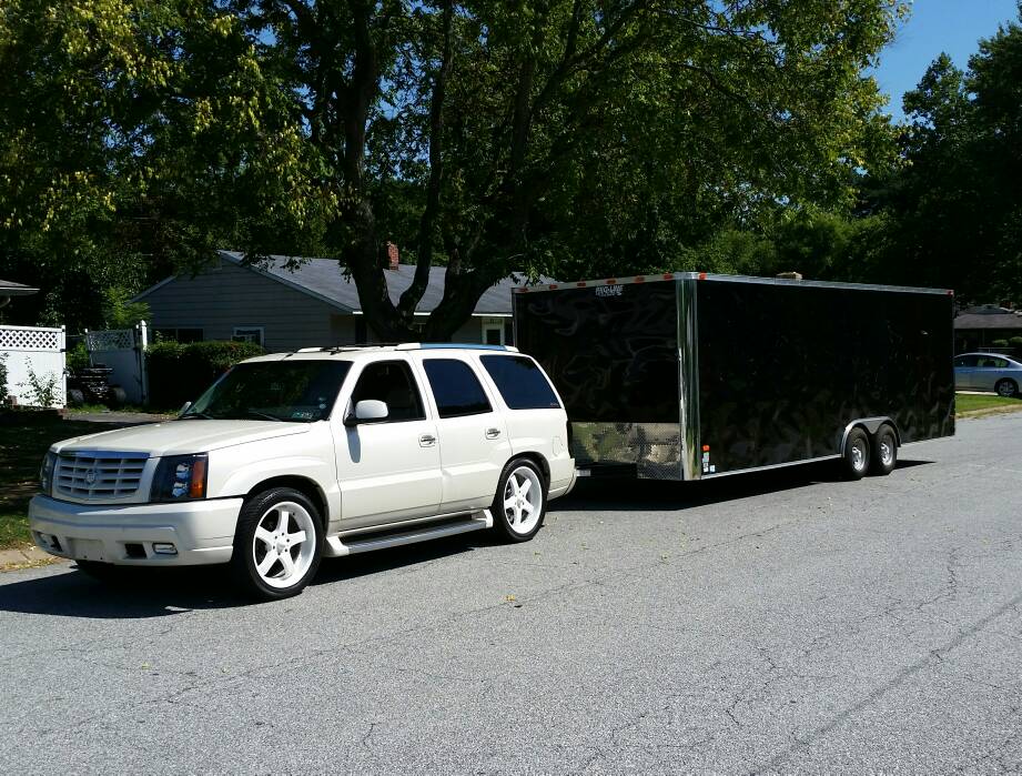

Ur pushing it to the edge. I know the hitch rating on my 02 caddy with the 6.0 was 12k.
7k worth of 24' trailer and transam inside.
Drove 800 miles one way from PA to KY... Even the big 6.0 worked for it... pulled about 9mpg on the highway and the trailer brake was a MUST at this level. Especially with the emergency button on the controller for the time the trailer started getting a bit out of a hand for me comin down a mountain. A lil drag on those bug declines was KEY...
