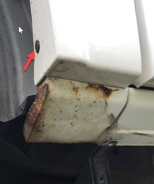

From what I have read and seen, folks use a heat gun and plastic scraper to remove the cladding and Trim.

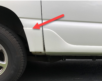

This is the trim piece i need to remove. I see two two of the black clips and probably adhesive holding it on. Just don't want to damage the trim.
Thanks
S
Sdp1234
Apr 1, 2019
120
58
Southeastern PA
Just removed the two clips and heated around the edges with the heat gun. Panel came off easily
