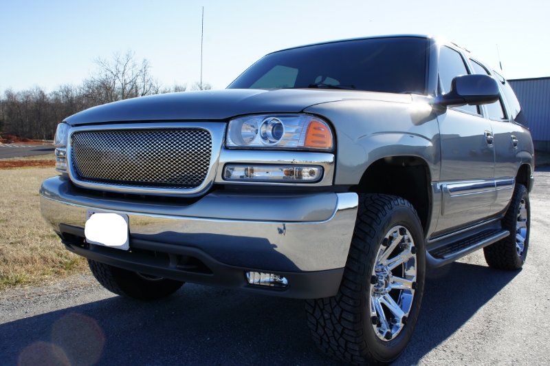

I havent been on the board at all in the last few weeks, but I just got done with my retrofit. I picked up a pair of the Denali headlights on ebay, got the Morimoto projectors from www.theretrofitsource.com . I got some adapter plates from a guy named John (thedrummer) on www.gmfullsize.com . He is a pretty cool guy, just message him. You have to find someone that makes these, as they are not commercially available. I took out the old projector and put the new projector in and siliconed them in to make them water tight. Waiting on Spencers HID's to come in...........kinda irritated about that.......but whatever. Here is a pic of what they look like finished.
They were really simple, it was just a couple bolts. Here is a shot of the stock projector...
And here is a shot of the Morimoto, in the housing, but you can see the lens is clear and doesnt have that wavy glass that diminishes the light.....
