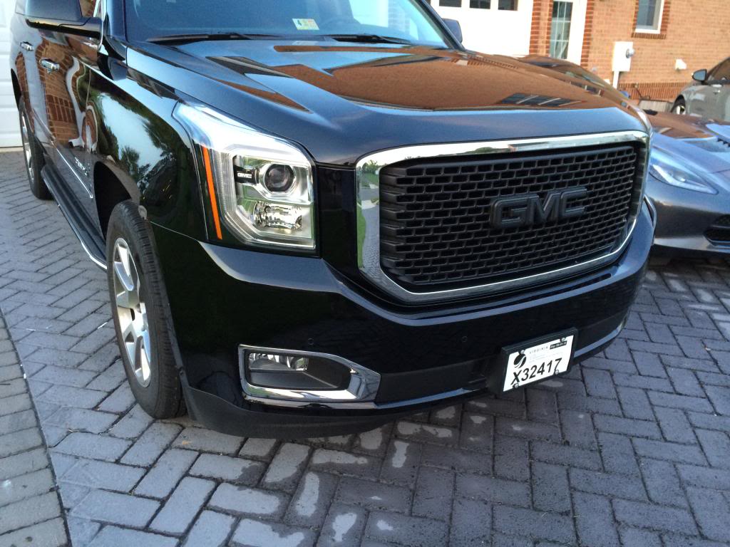

I ordered the Denali grill and will attempt to install. We are in the install Biz for Public Safety equipment so removing the front end plastics should not be too bad. I'll try to take pictures and document what needs to be done.
A quick look reveals inner fender well screws, top side molding screws and probably inner fender screws. Lots of hidden stuff that you can't see unless you remove other panels. This will also allow me access to the Pass side headlamp to change out the bulbs. Looks like you have to remove the airbox (Airfilter) to gain access to the pass side bulbs.

Looking forward to seeing install feedback.. Any pics you can take along the way would be great.

I second that piper pilot. A full write up will help us all immensely.

It is very easy.... I installed an OEM one last week on our XL SLT. It took just over an hour by myself. The only area that is tough and where you need to be careful are the tabs at each corner of the bumper just under the headlights where it attaches to the fender. once everything is unbolted the tabs still hold the skin on pretty tightly. Unfortunately, I didn't take any pics of install.
I used the putco online instructions to determine what bolts needed to be removed.

BTW - A cordless drill for the 7mm and 10mm will save a lot of time vs a ratchet.
