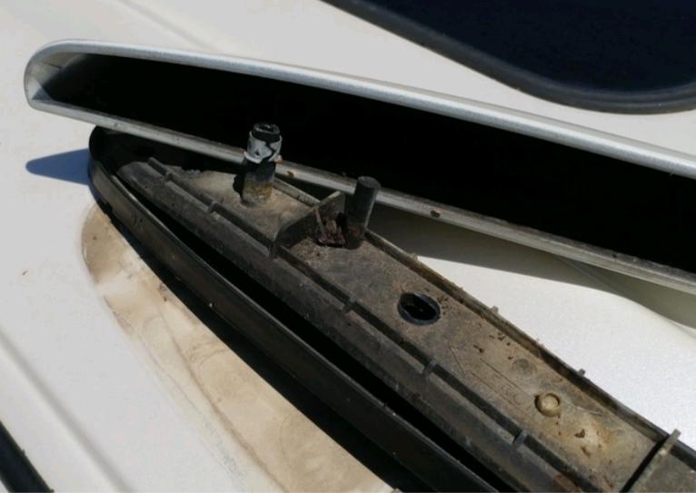

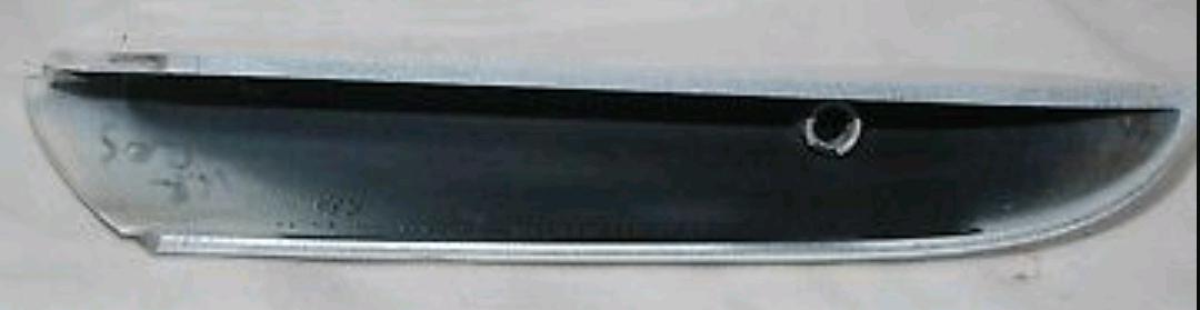

Here are some pics of the older (round post) style...
And a pic of the newer style that has the flat piece...
You see the flat vertical piece to the right of the bolt???
A metal clip attaches inside the newer style end caps and slides down over that piece.

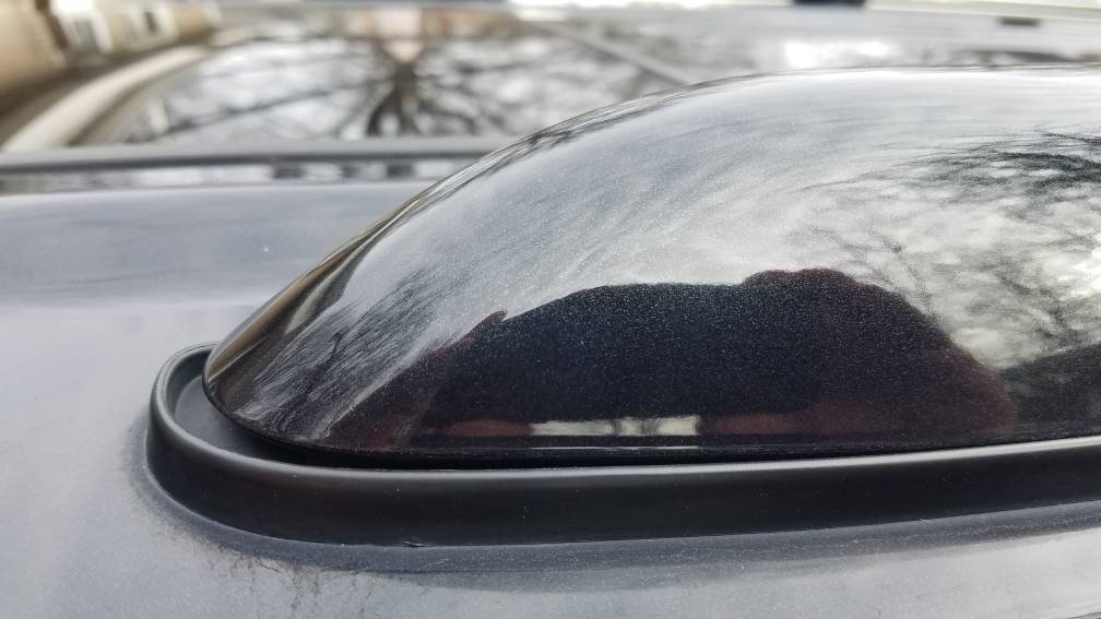

Can these be set down into place by hitting with the palm of your hand or does it require more force like with a rubber mallet or something? I just don't want to use too much force trying to seat it down flush to the gasket and damage it by having the post/flat tab start to push up through the top.

Palm of your hand is all it takes to seat it with the post style fitting. I have the post style fitting on both of my trucks.

Mine is the newer style but as Foss pointed out... palm of the hand is all you should need.

They simply snap into place. Pushing down on them by hand will be fine.

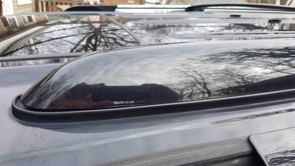

I guess that's as far down as they go. Both of my fronts are like that, they have about 1/8" gap at the very front tip. The rears are fully touching the gasket the entire length. It's just the fronts, and only the pointed part, that doesn't quite sit on the gasket. I've tried pushing them down and hitting them with my palm to seat them down further but they won't.
