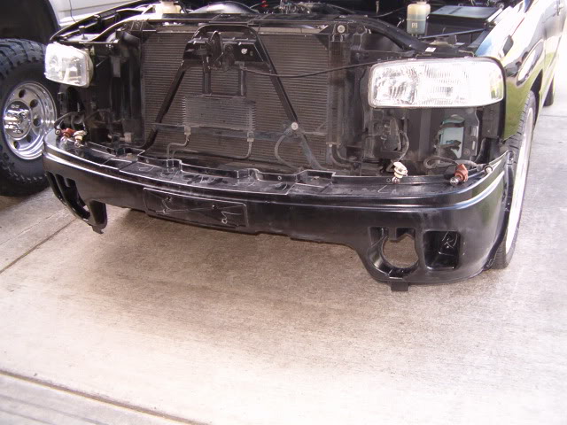

My goal is to transform the front end of my Yukon into a Denali. I am aware that to do so I will need to change out all my lights, grill and bumper cover. But I have a question about the bumper now. Is this cover below all that I need? Will I just use my existing screws and mounts to put this on my truck? Or will I have to buy the full bumper? I found this one for a pretty good price of $100.

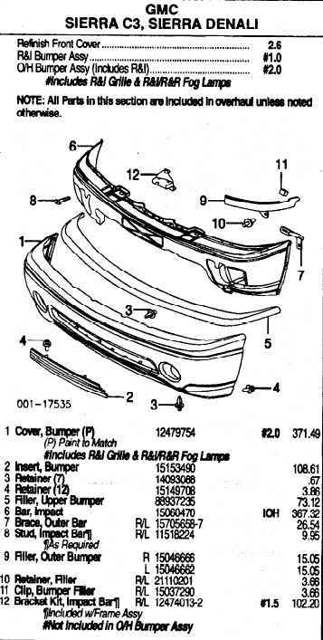

That's just the bumper cover. That's the first piece on the list below. You need a lot more than that.
You will need....
Denali front end conversion parts
12479754 - Bumper cover
15046662 - Filler between grill and bumper - LH
15046666 - Filler between grill and bumper - RH
15199554- Parking lamp – LH
15199555 - Parking lamp – RH
19130789 - GMC Denali Grill superceded
15218077 - Headlight – LH
15218078 - Headlight – RH
14093088 - Retainers (7 needed)
15149708 - Retainers (12 needed)
15153490 - Insert
15060470 - Impact bar
16531085 - Fog lamp Assembly – LH
16531086 - Fog lamp Assembly – RH
15059859 - License plate bracket
88937235 – bumper filler
15706323 - emblem
88944418 – Fender right
88944417 – fender left
12477699 - Hood

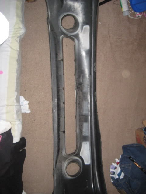

My only question was about the bumper. I am aware of the grill inserts, lights and all. I just want to see if I can use my existing brackets to mount this bumper cover on? That is really my only question. Thanks!

Ok I found out that I really really need the Impact Bar, Item #6
Which should bolt right up just like this...
Someone please correct me if I am wrong. Thanks!
