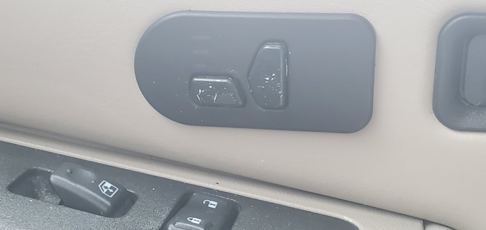

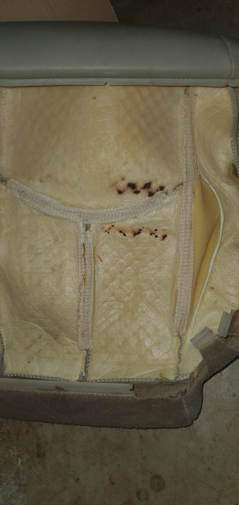

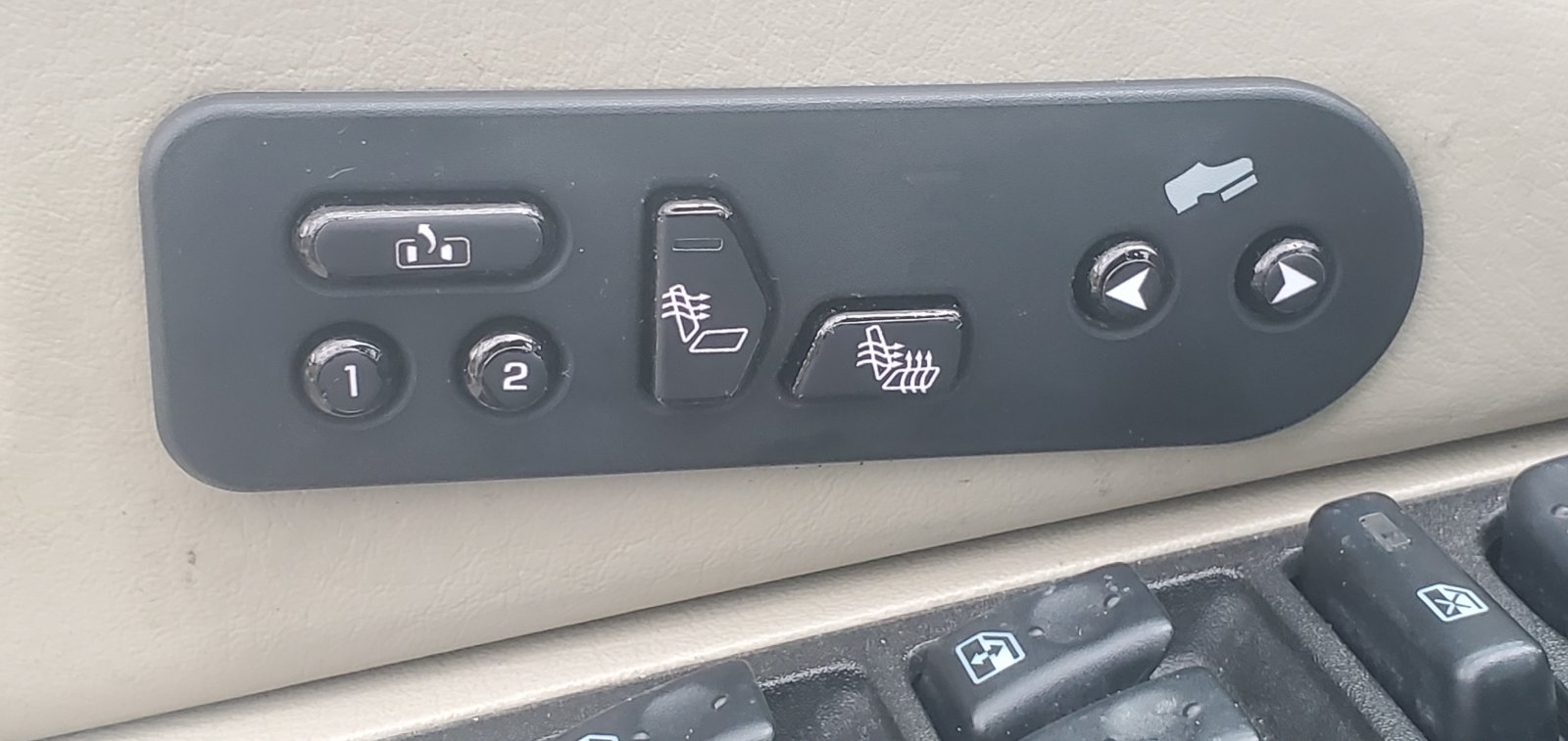

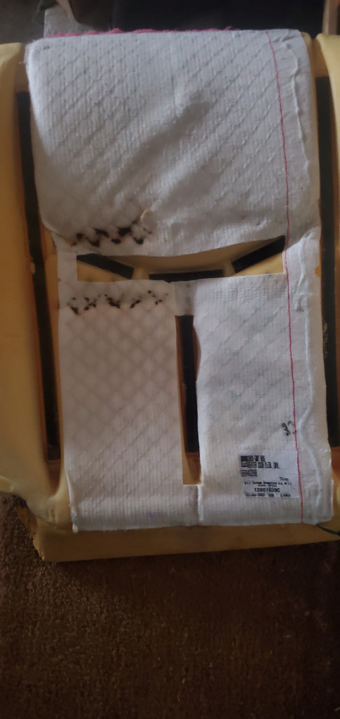

Finally got around to doing this lat night, didn't realize the design of the heater element was quite this dumb, whoever thought it a good idea to lay the wires in a crossing, grid pattern? On something people sit on likely every day.
No wonder these things short out left and right.
Replaced with an element from the seat shop and it does not have crossing wires.
Replaced the seat foam and the cover as well, and voila, no more ghosts turning my seat heater on and off.
Also took care of the peeling buttons, got the vinyl stickers off of ebay and so far I'm pretty pleased with the results vs. buying a whole new switch assembly
