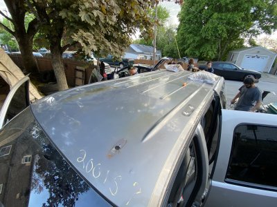

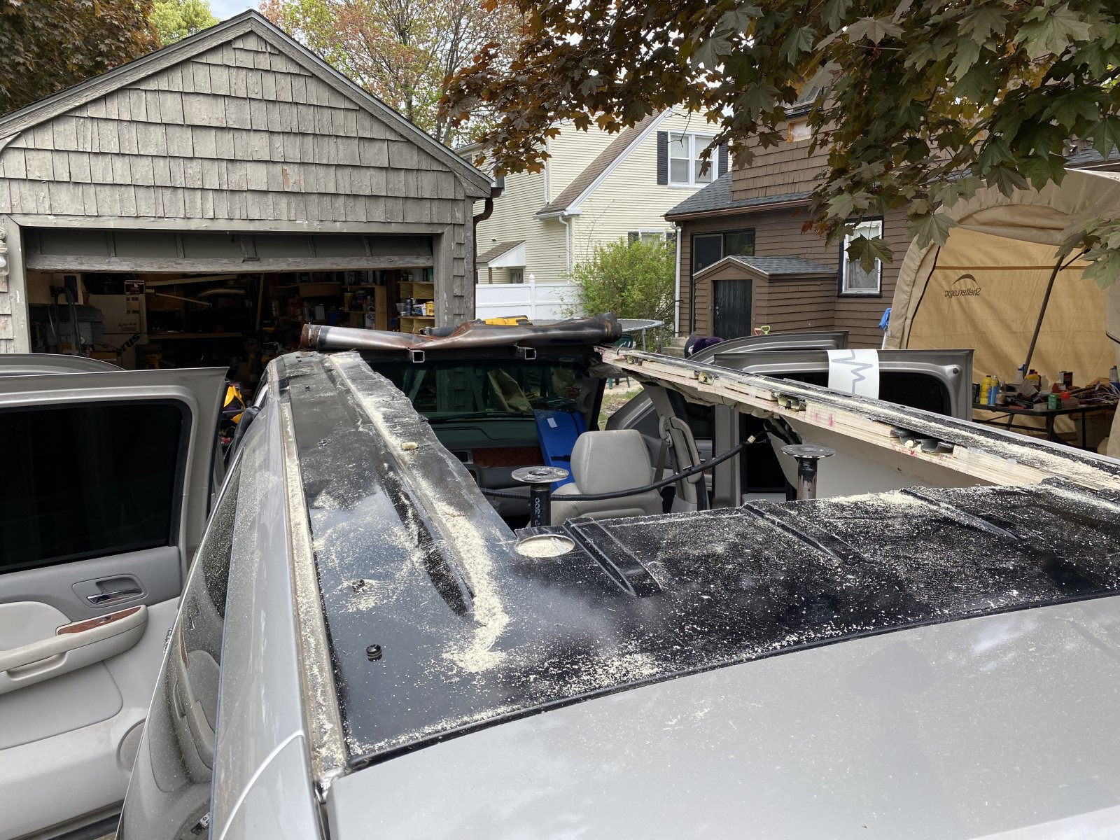

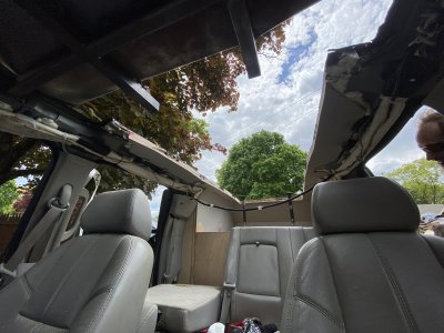

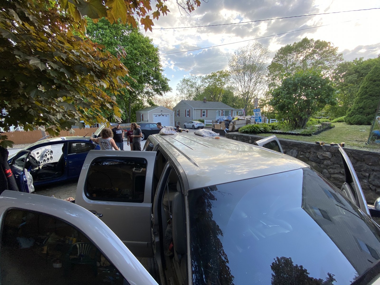

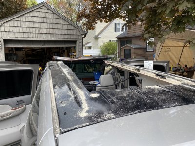

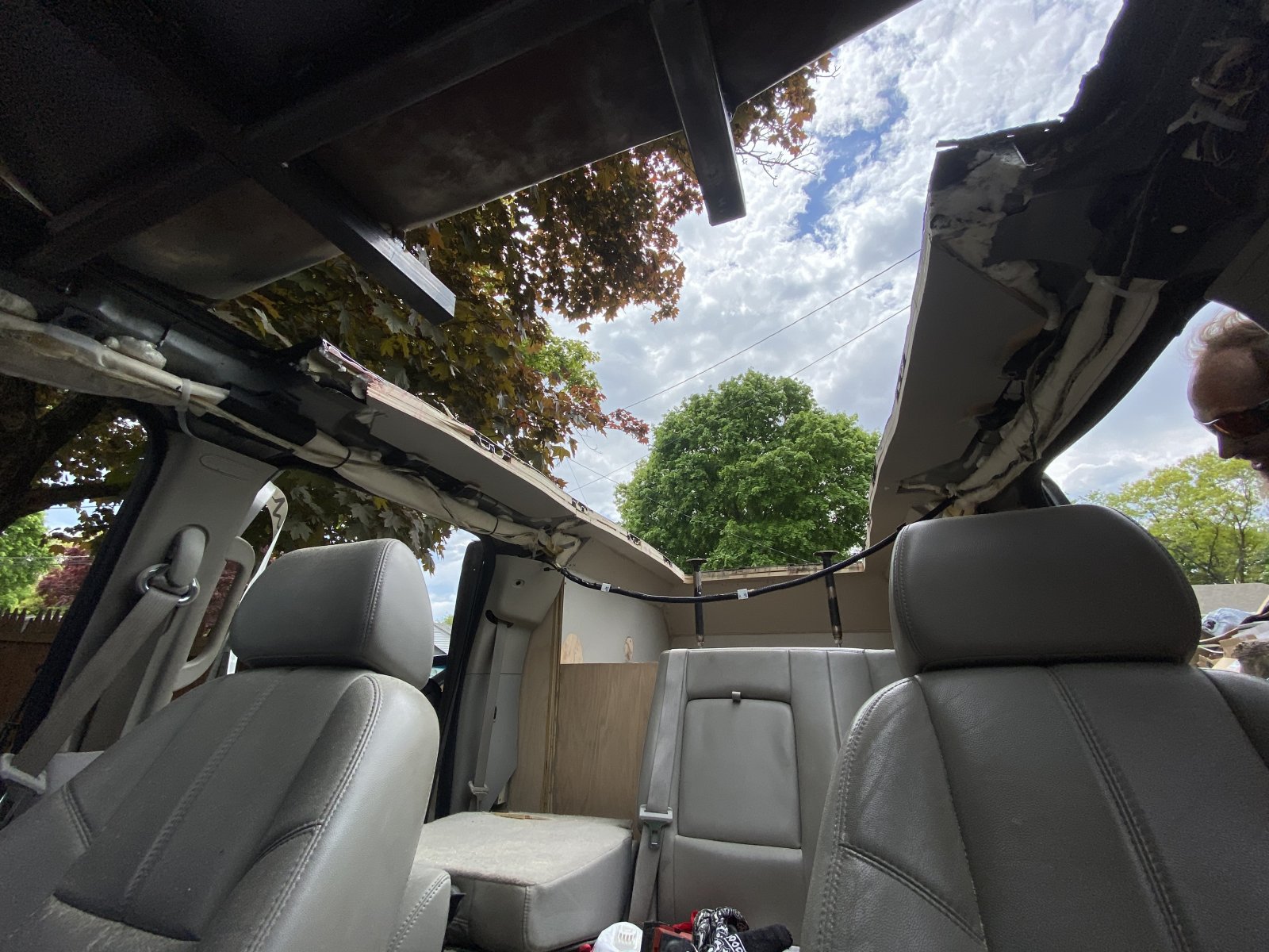

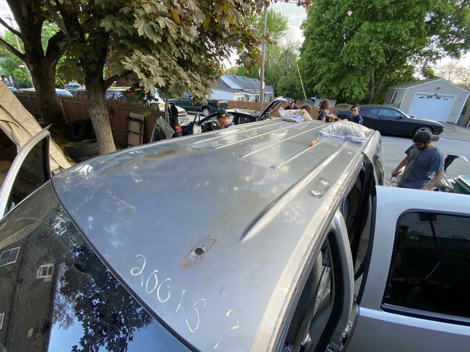

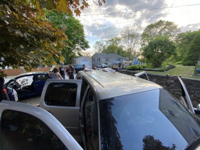

Had issues with the original roof and multiple attempts at a sunroof delete so finally pulled the trigger and replaced the entire roof skin with one from a base model Suburban. Really wish I could post videos on here

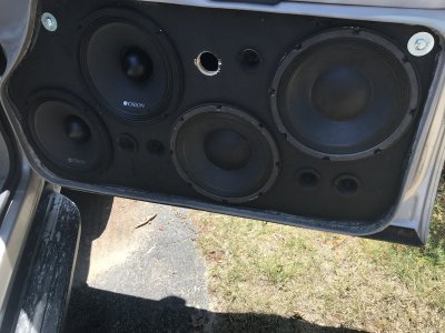

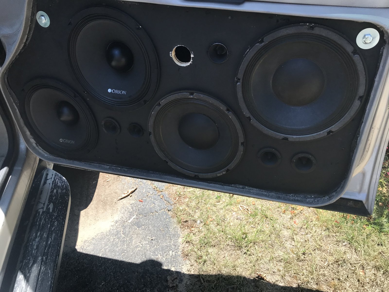

By the way, I say that little blue car behind you needs more speakers in the doors. Must sound like a church mouse going down the road.

Why the roof replacement? And why the sunroof delete? Was it causing issues? Also you can post videos here by uploading them to YouTube and then copying and pasting the link into a thread response here and the forum will automatically import the video link and make it visible in the thread.

unfortunately I didn’t take many progress pictures along the way. The pictures with the roof on is finished product
these are the doors on my truck btw

Had to get rid of the sunroof for bass purposes

i think you can fit more speakers in the doors . its not enough until your ears bleed right! joking aside ive done my share of patch panels and and panel replacements and i think i suck at it. i probably would have just bought one without a sunroof. but i geuss swapping all that equipment would be equally as aggravating. regardless looks good definitely should have taken more pictures or a couple good videos.

No Fear! Get er done and move on to the next step. Are you going to mechanically seal or use adhesives to secure the roof skin?

I used both methods, seam sealer and welding
