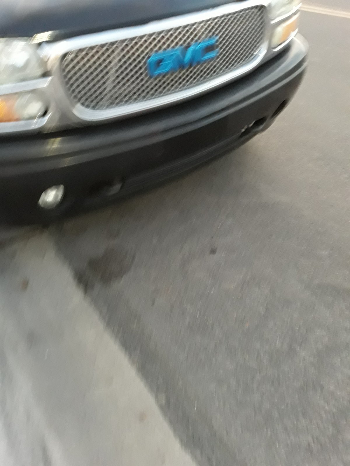

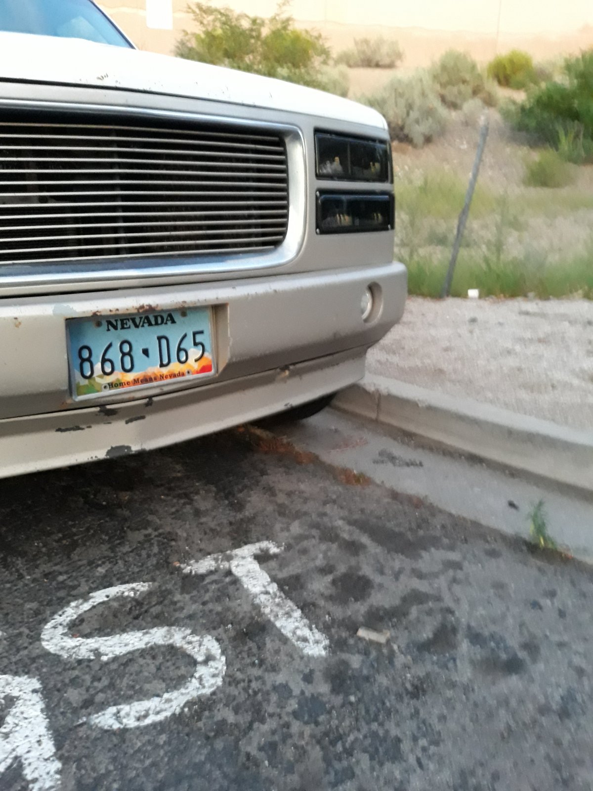

How do I Finch my license plate on this plastic bumper picture from my 99 as example

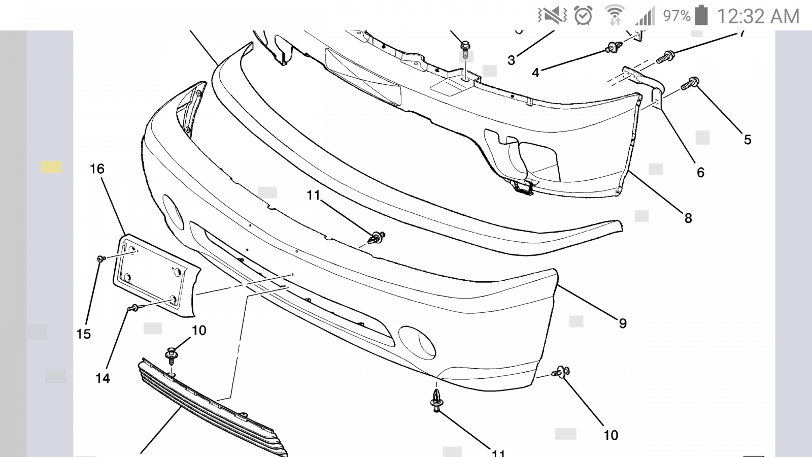

i wonder if there’s room between the bumper cover and bumper to do this or if you have to modify both?
52,954
It’s just a skin on top of the steel bumper so both would have to be modified.

Wonder if you could remove the material the size of the plate and all about 3/4” on both sides and top with fiberglass then shape and paint? Hmmm...

There are more compatible products. I worked on a cowl for a Harley and used a plastic epoxy made for it. You have to buy it at an auto body supply place. But you will have to do some cutting and welding of the steel bumper bar which the plastic wraps around first. It’s pretty easy to remove that plastic skin, I recommend doing that first so you see what you’re dealing with before deciding on what to do. It’s just a plastic skin that covers the actual steel bumper.

It's been a little while since I've had mine off, but I think the Denali bumpers are composite under there, not steel.

He’s only looking for about an inch so I’d think there’s enough room or flex to pull it off. I don’t think that part of the cover is attached to the steel behind it. But if you do have to cut the steel I’d pass on this.

It is not attached there, and yes, there's a bit of play. Maybe not a full inch, but enough to recess a plate, for sure.
