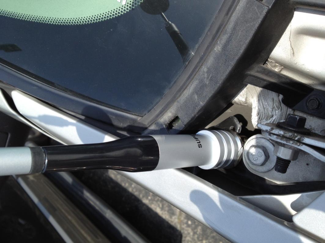

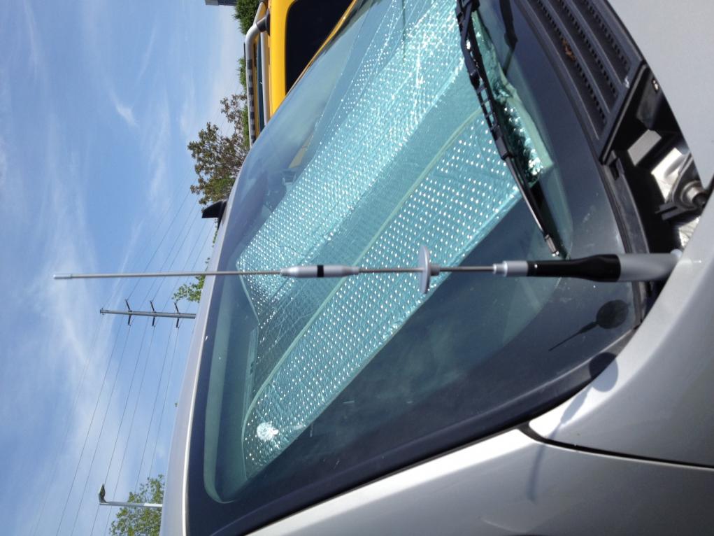

Here are pics of my MFJ Short Mobile HF Whip into the existing mount position on the drivers side of my 2009 Yukon.
