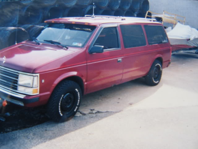

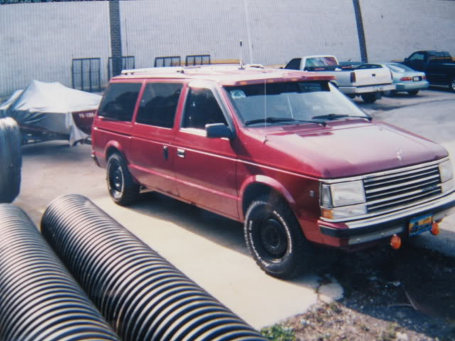

Good set of all-terrain tires and a minivan could do fire roads lol.
Been there done it. :waytogo:

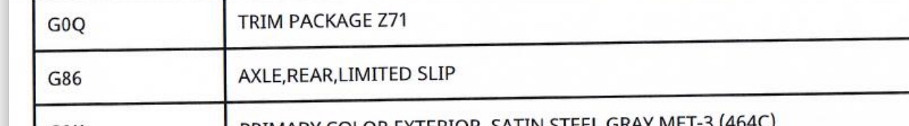

21 what? pickup, the g80 is for solid axles, the elocker is g96, the new mini rear diff is a g86
Per my info, 2021 Tahoe Z71.
Yes, you are correct. Mine actually came with a G86, axle, rear, limited slip:
