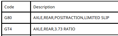

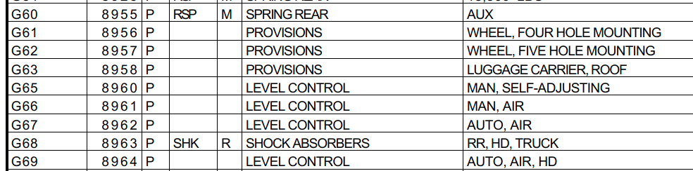

You must have had that noise before the idler arm replacement, to find what you described. the GT4 is the RPO code for the 3.73 gear but G80 would be the limited slip diff. The G65 is not one I am familiar. The G66 and G67 have to do with auto and manual leveling.
G65 is the RPO code for the rear manual self-leveling Nivomat shocks, if they're still on the truck. Part of the Premium Smooth Ride option.
I looked at 2 different GM RPO codes lists and they both went G60 and the G66 and then G67 and did not show the G65.

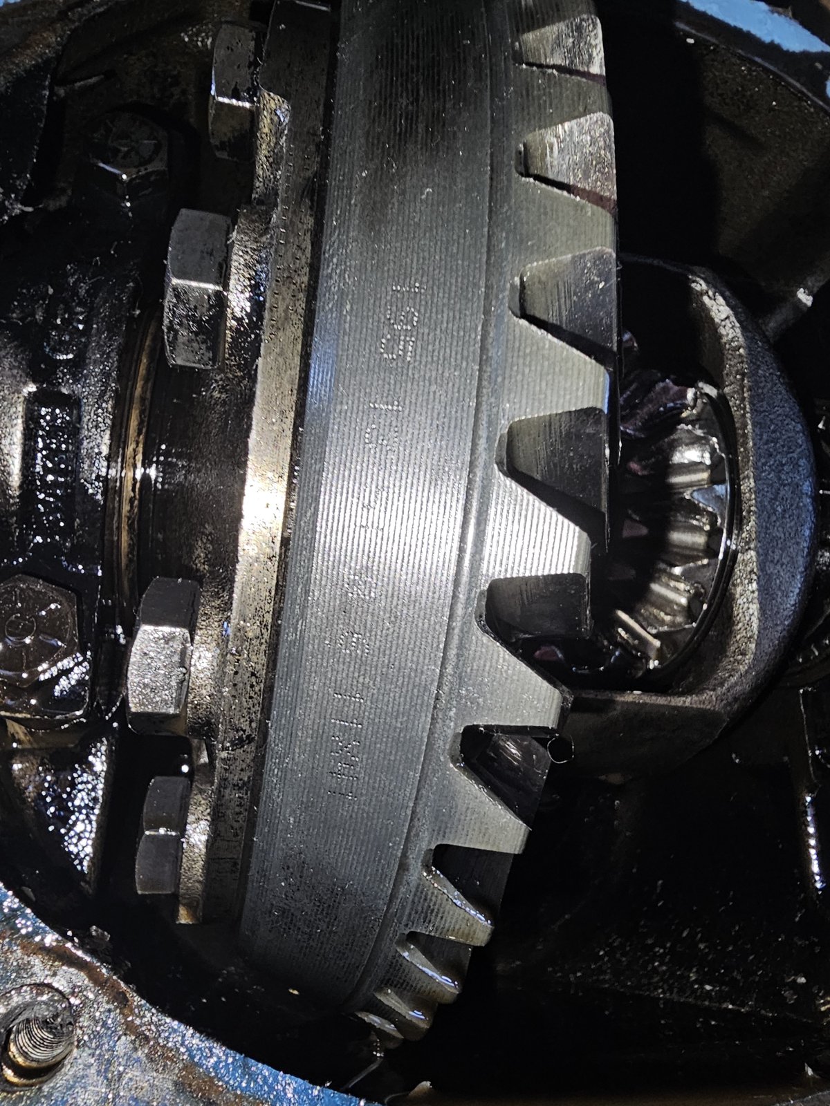

ya went back through codes. just gt4 -3.73 nothing says its a posi . so i guess i get to disassemble the rear diff over the holiday weekend i know its a 10 bolt and it says 8.6 on the ring gear. there are some other numbers im not familiar with.
So....are you planning on installing the gears yourself?

It can be and is likely the same. Depends on if the regular chevy truck had the same housing or was a full float axle or whatever. I have over 35+ years in shops and I never swapped gears in a housing. My shops either just installed a new or used differential or I had a specialist that built them. I do know that one of the things I was told to do was to initially start out with the same shim set up as in the housing now with the old gears. With the new, set it up first with those shims and see where the pattern is and adjust from there.
The thing that threw me, is your statement that the noise was after the idler arm install but with the condition of the gears, the noise had to be there before.

Thank you for your help very much apperciate it. I agree noise had to been there for awhile. I just never heard it. Wife drives it more than me
