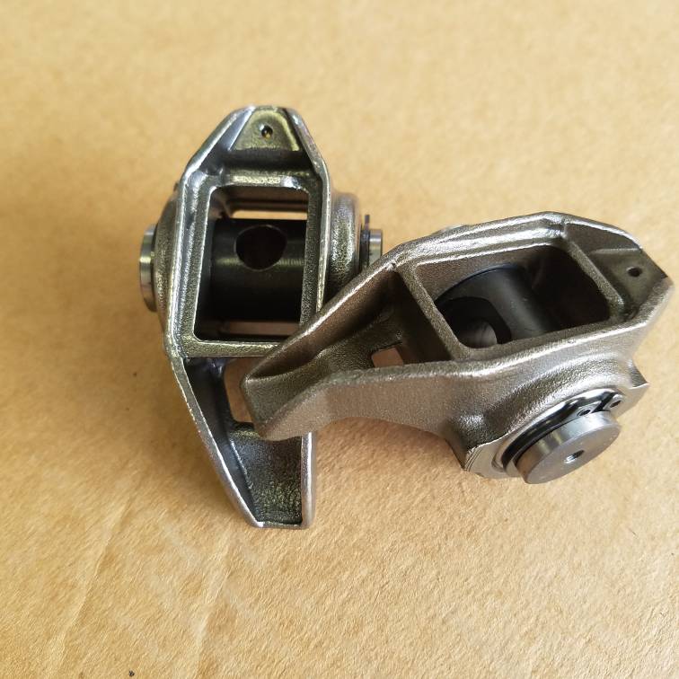

What trunion upgrade kit is in those rockers? I installed the Comp Cams one in my stock rockers myself. It wasn't too hard.
I bought them off ebay, but the seller says they are the BTR trunion kit.

I've heard Brian Tooley Just rebrands the Comp Cams kit. It sure looks the same.
BTR sells their kit for less than Comp and seem to compete directly with them. Comp was having all kinds of QA problems with their cams and trunion kits when I got my trunion kit. I purposely avoided Comp. I hope they're not the same.

They did have some problems a couple years ago but supposedly took care of that , at least I hope so.
45,012
Wait- what issues did the Comps have? I never saw or heard of anything about this. I have a Comp trunnion kit in the built 243s slated for my 5.3. They were assembled 3-4 years ago for another build and never used. I don't wanna follow up deleting the AFM lifters with the installation of defective rocker bearings!
