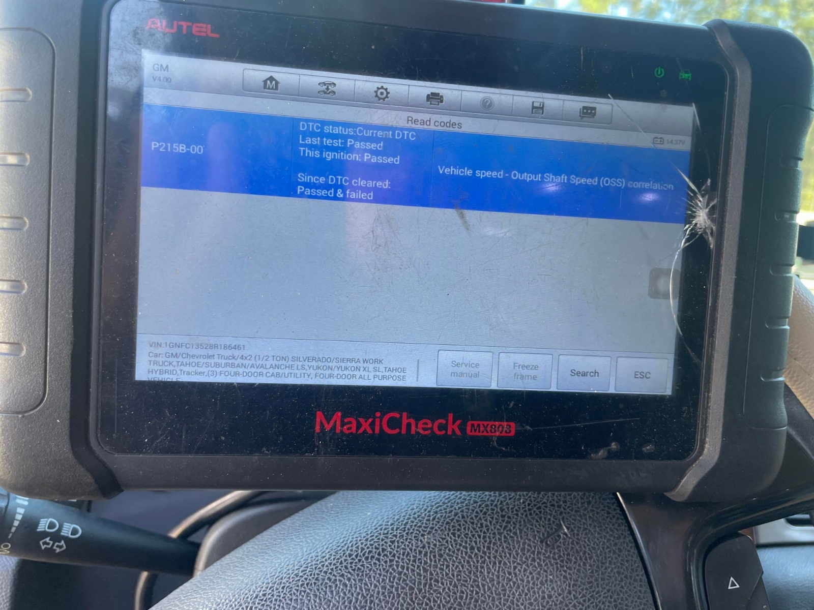

This is an offshoot of another thread I started thinking I bricked my Tahoe after putting in an aftermarket radio. I since realized that I blew my BCU fuse. Replaced it and it started fine, but then redlines and dies. I've paid two mechanics to come out (because I can't take it anywhere) and paid each $150 to tell me that my hybrid battery needs to be replaced. I don't think that's really the issue. Another code that popped up was the P215B-00 - Output shaft correlation. I called the hybrid specialists who installed my battery and they don't think that the battery is bad. Unfortunately, they are about 45 miles away, so a hefty cost to tow if I need to take it back to them.
Could the output shaft sensor be causing the issue?_nc_ohc=AyQ4vMIZbs8AX9ON_mE&_nc_ht=scontent-lga3-1.jpg_nc_ohc=NKMm_LI829sAX-McYBf&_nc_ht=scontent-lga3-2.jpg_nc_ohc=Qk6O1Ju-g8oAX-Hrf4T&_nc_ht=scontent-lga3-1.jpg_nc_ohc=NHCBEUmRwvsAX_L92KW&_nc_ht=scontent-lga3-1.jpg

took a quick look at your P215B-00 code it looks like it sets if there's a 10mph different between wheel sensor and output shaft speed. I'll upload the sheets later. I doubt you've been driving it so not sure how it set. unless there's a short it open in the wiring to it. does your scanner show freeze frame data?

I feel like this isn't going to be of much help for you. but this is all I got for that oss code.
wait.. OK. so I just realized the scanner in the pic is probably the to guys you called out. in that case they needed to click into each of those faults and see what the code said. if I had to guess since there was one fault for each module, the fault code was probably something like lost communication with with the body control module because the fuse was blown. sadly that's probably useless to you, and the code for the oss, I wasn't paying attention, but if you read it. that code passed last test. there's no current fault in that sensor.
sorry to say man, at this point you're going to need someone who's better at trouble shooting new cars in general, hybrids more specifically. cause the regular guys are always going to blame the system they don't care to learn about. I agree with you that it's probably not the battery. you'd definitely need more data to completely rule it out but I don't see it there.
