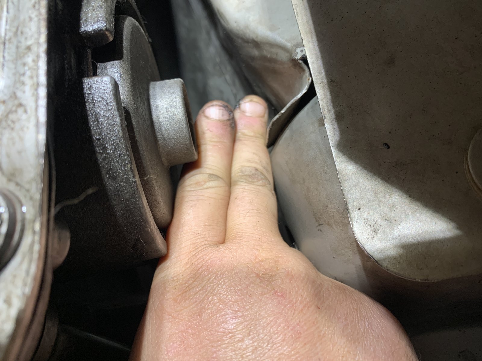

So I got my corvette servo and want to install it but I am very concerned about the clearance. The vids and pics I have seen all show the servo reassembled but I am having a hard time seeing how that is going to fit.
There is less than 2 fingers clearance (see pic) and I am concerned.
Is this normal and does the servo go in and out without issues?

Havent done it on the Tahoe, but my old blazer required me to pull the transmission mount and drop everything as far as the crossmembers allowed. Even then it was tight but fit.
