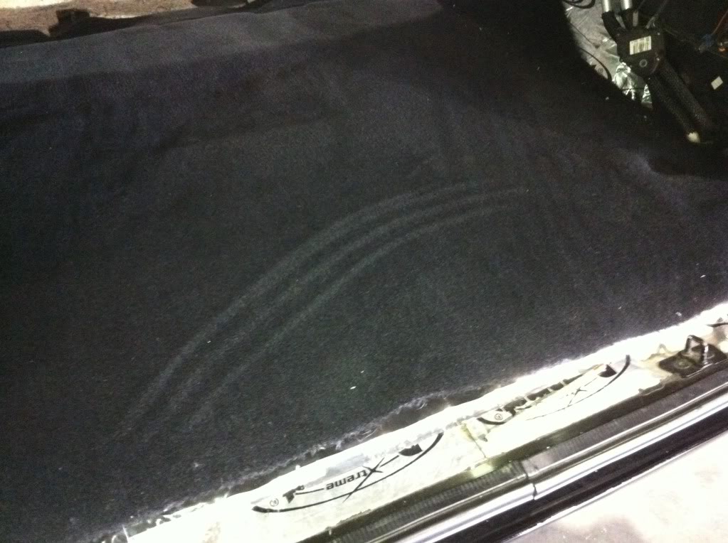

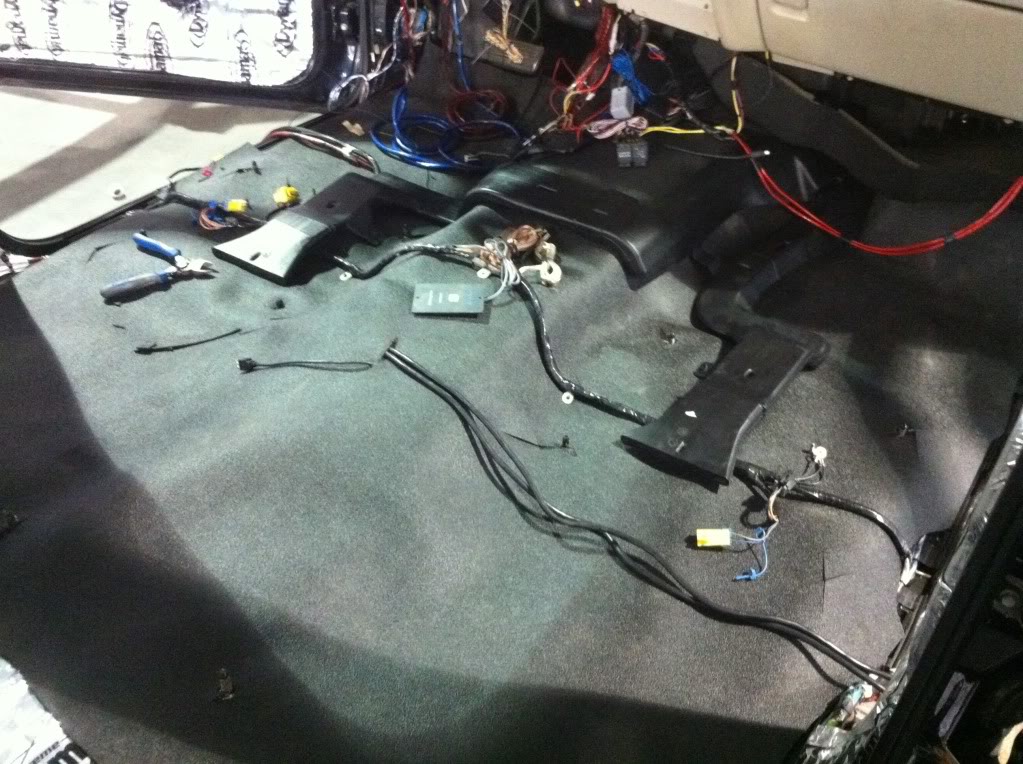

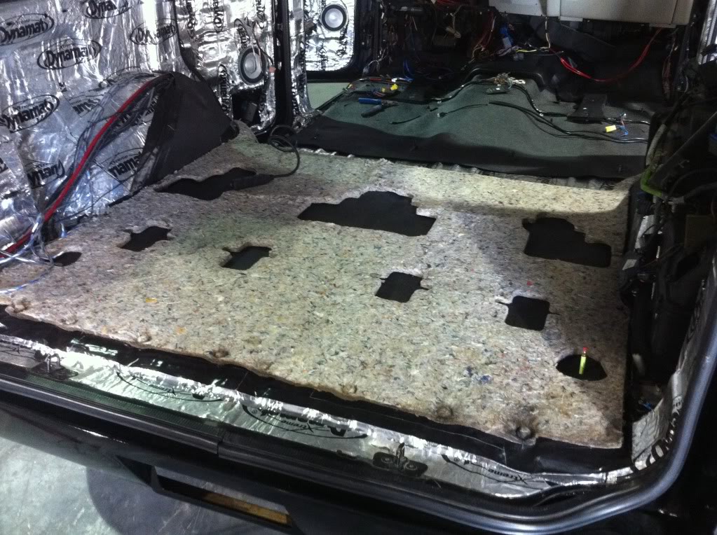

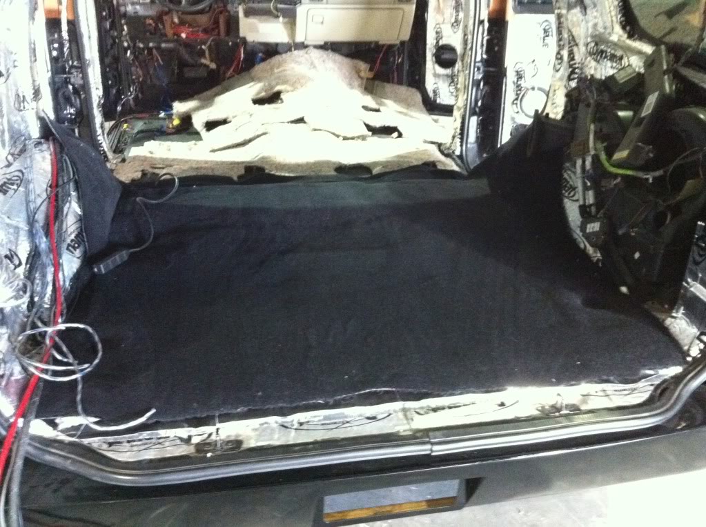

Finished up laying down the rubber sound deadener layer that came with the carpet, Front and Back. I am reusing the carpet padding that is still in good shape along with the padding that came with the carpet for nice soft floors. Also I finally laid some carpet, and let me tell you it is pimppppp. The ultra plush carpet is gorgeous, remind me of my Grandma’s S500 carpet but better. Should be finished up with the front by early this week then I’ll be concentrating on the seats and door panels.
Cell phone pics, I’ll post some better ones once the front is done.

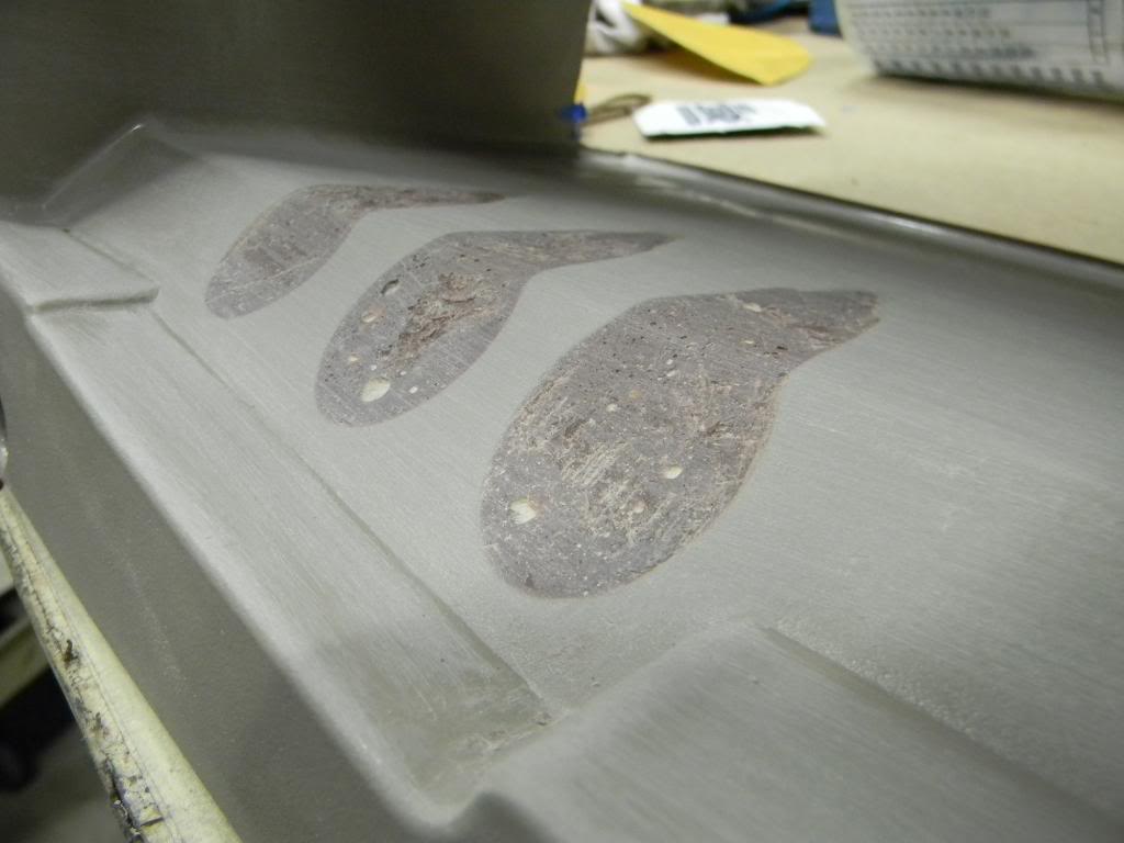

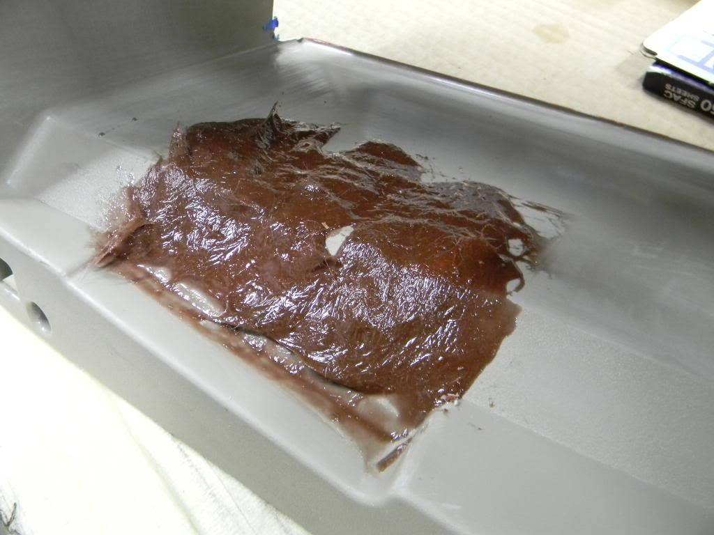

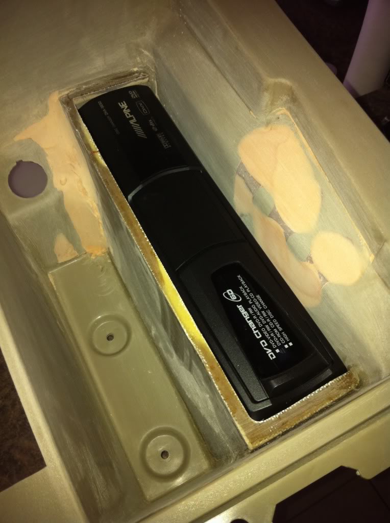

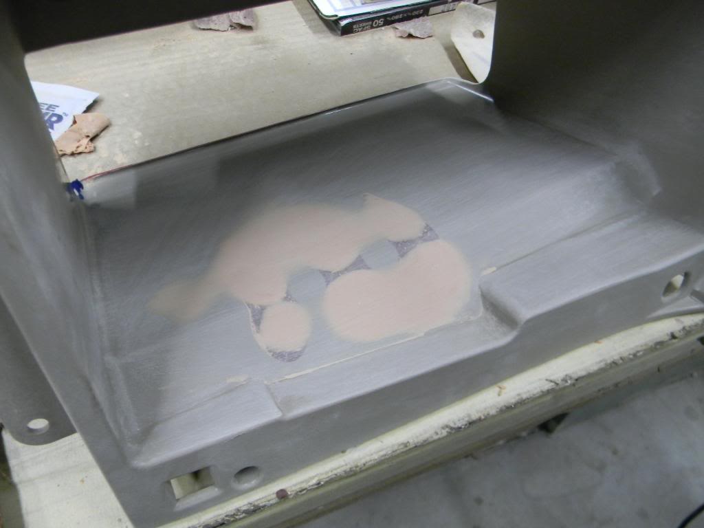

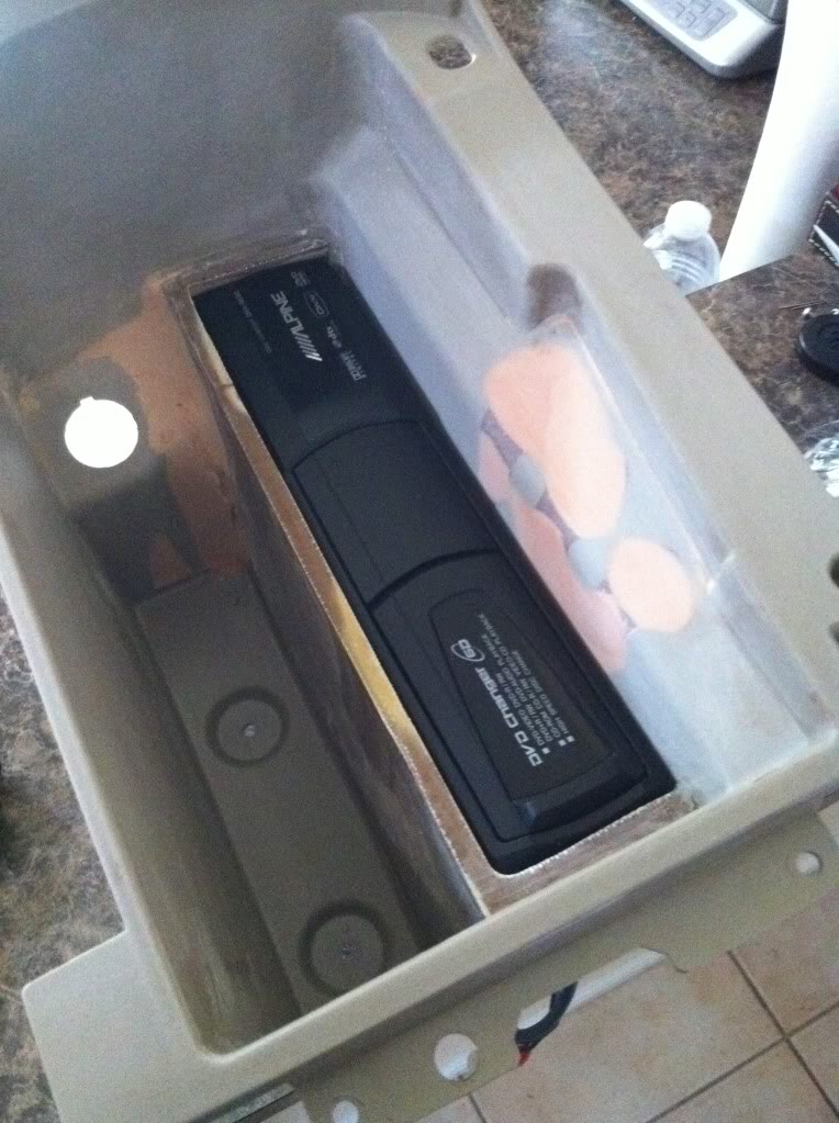

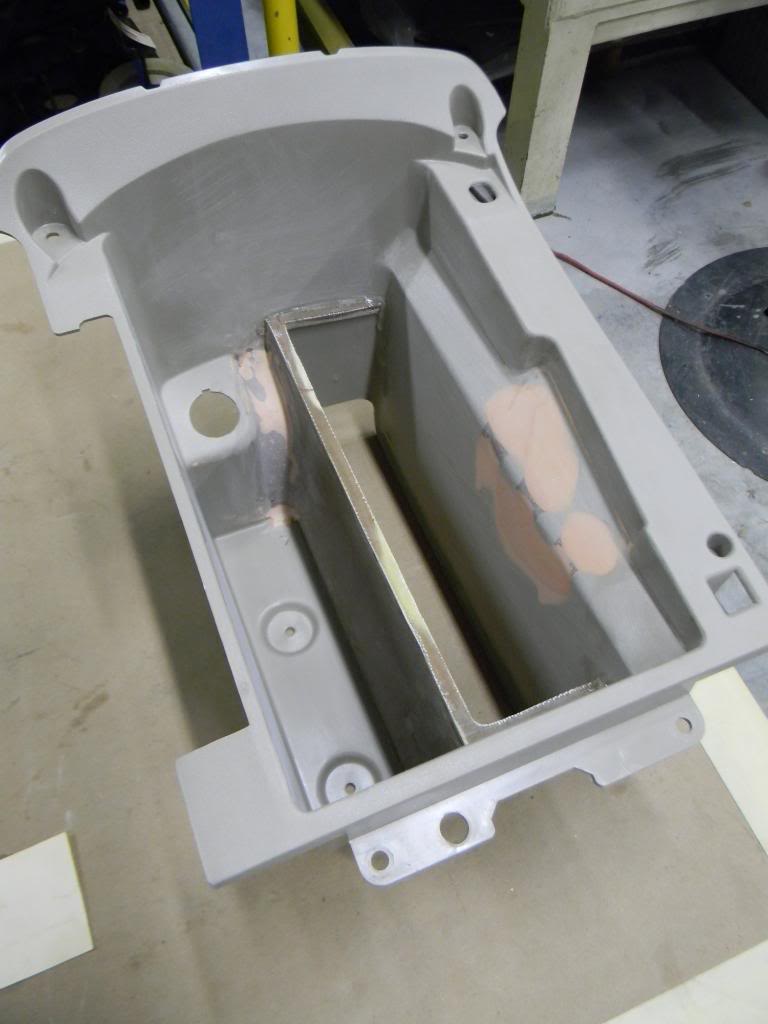

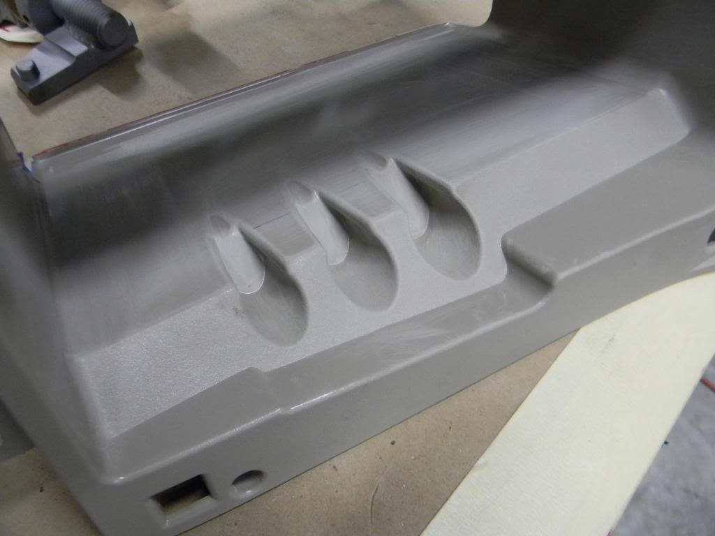

Started finishing up the center console b/c I want everything set before I lay the front carpet down. Here is the work so far, plugged the coin holes, attached the changers frame with epoxy and filled the void in between the 12v power plug and the changer frame. More filler and fiberglass matting is still needed, then I will be prepped for flat black paint.

Test Fit, a little too tight, a little sanding and she'll fit perfectly. I'll finish her up tomorrow...
