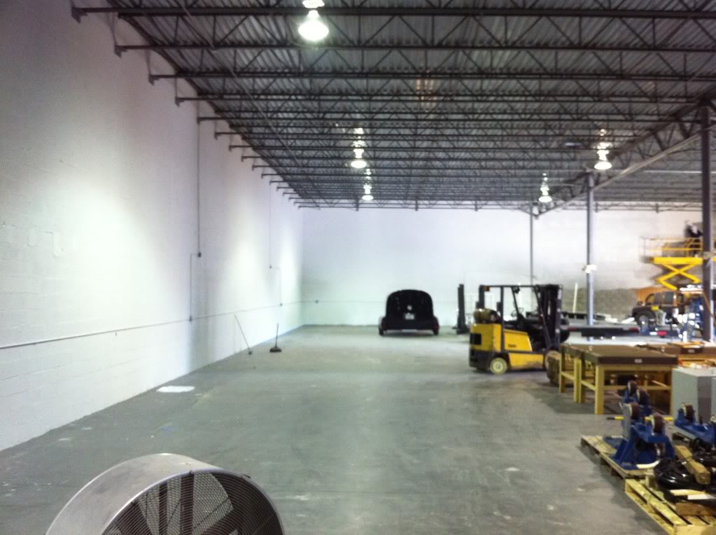

Painting all the walls now, helps tons with the lighting.

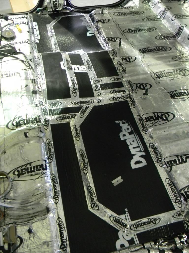

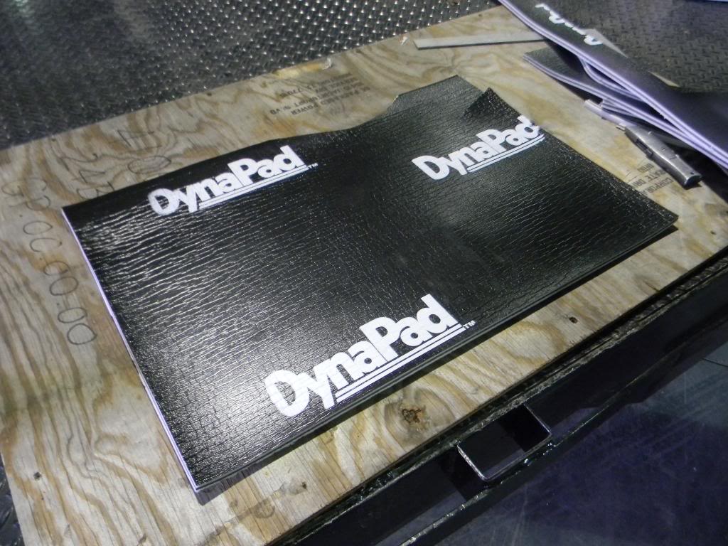

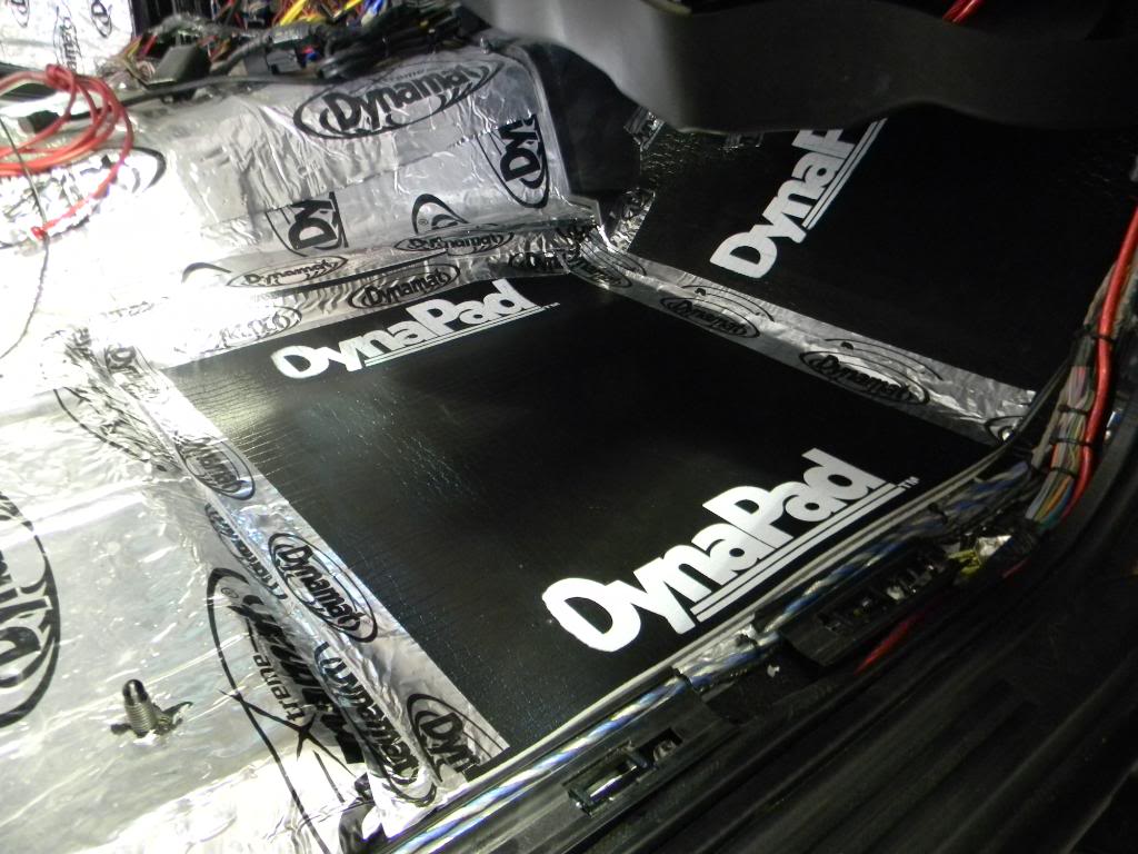

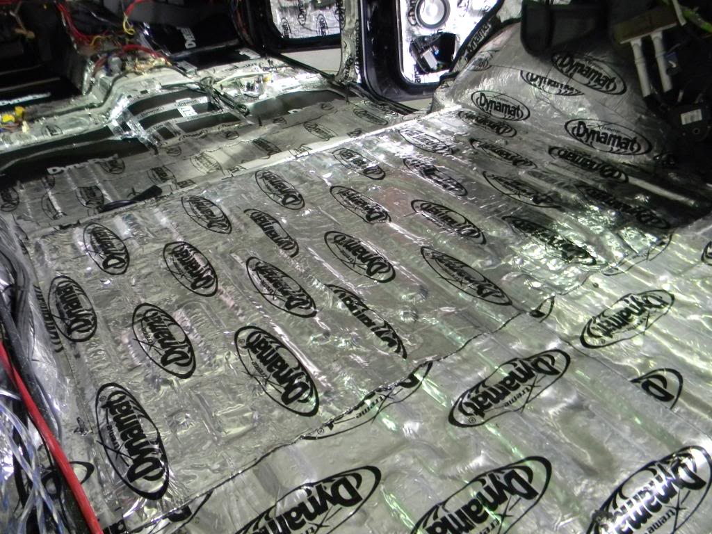

Alrighty I started laying down the DynaPad, cutting it so that it sits as flat as possible on the contoures of the floor and then keeping it in place with the finishing tape. After I am done with this, another layer of thick rubber material that goes with my carpet goes down then the carpet w/pad itself. I only had 2 Dynapads that were given to me so I wanted to get the foot areas done first and see what is left over, and it now looks like I will have enough to help deaden my sub box.
Pics…

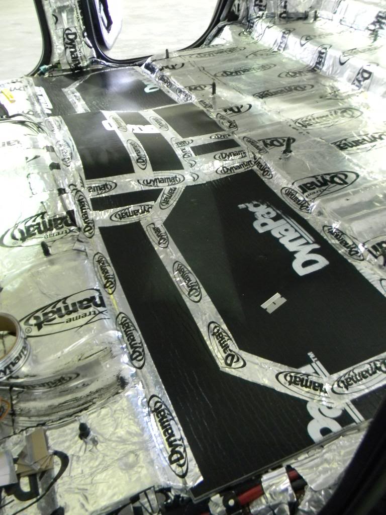

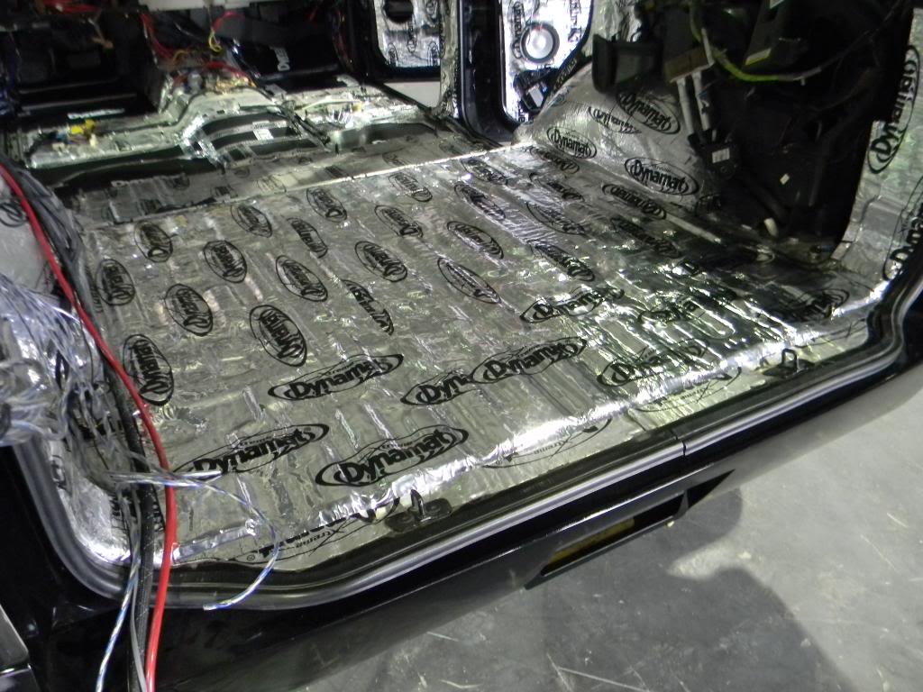

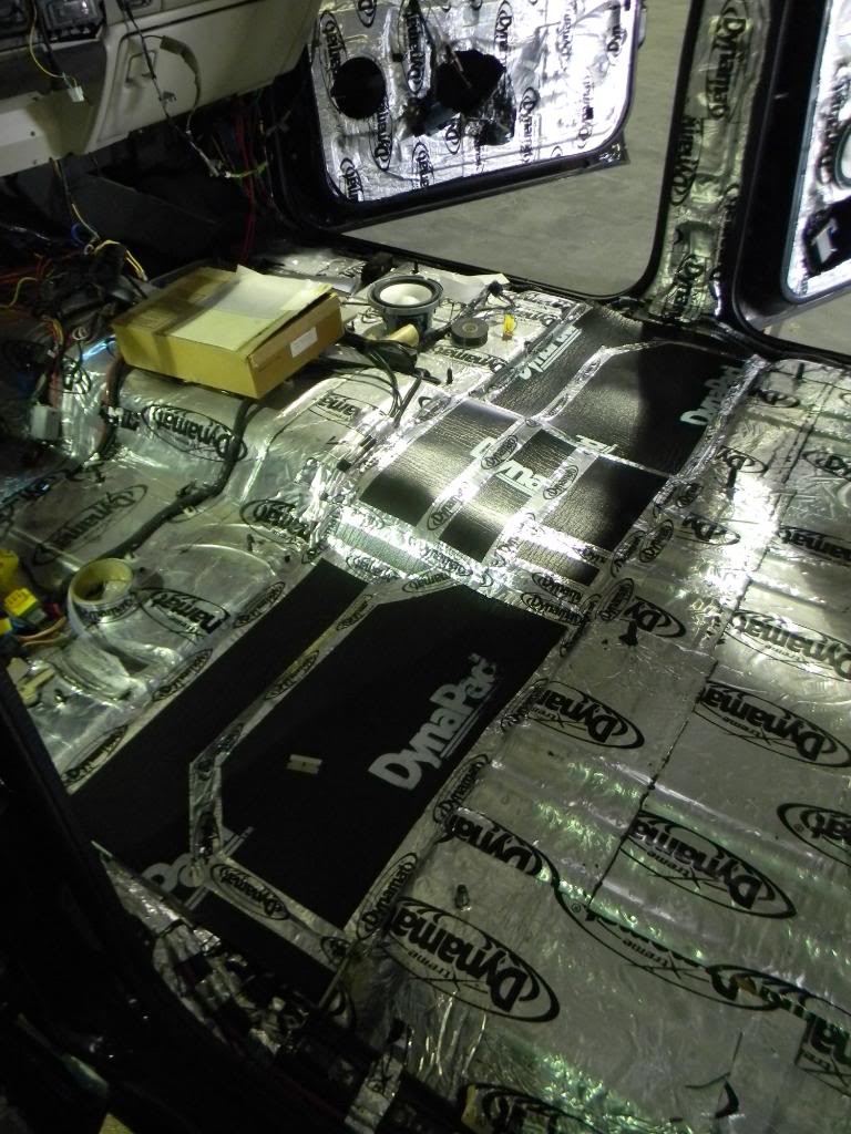

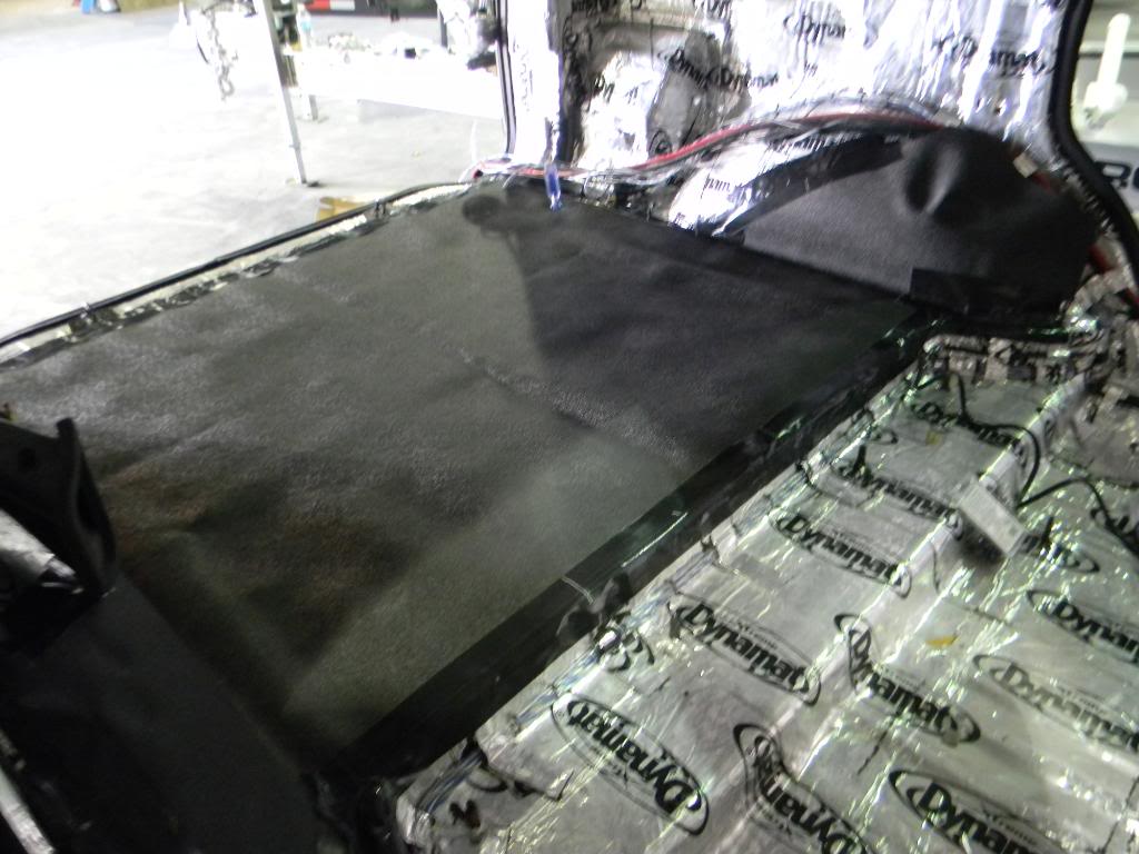

Finished up the drivers floor Dynapad and taped it up well to itself but not the floor so that it is easily removed to access the E brake cable below. Since I don’t have enough Dyanpad to cover the cargo area I did the next best thing and used the scrap cuts to fill the voids left by the 3rd row attachments, and then covered the whole cargo area with another layer of extreme. I still have a Dynapad 33”x38” big to line the sub enclosure once built.

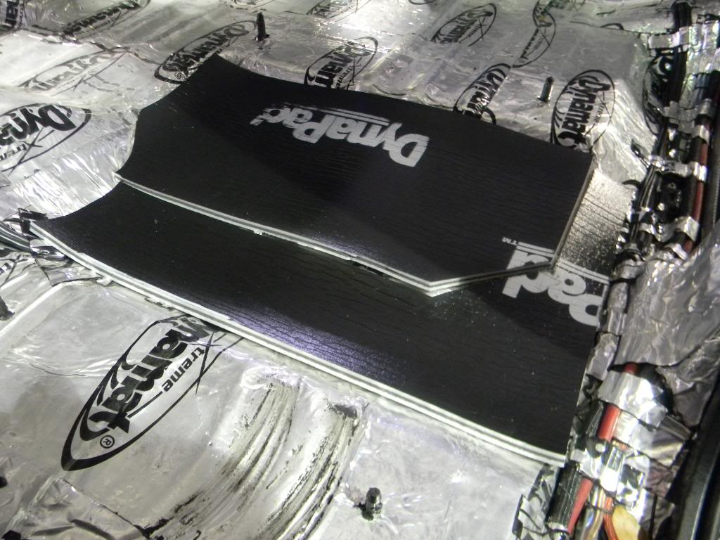

No I haven't....well maybe just a little. But I wanted a little extra in the cargo area b/c of the dual side exit exhaust system I'll be running, and I didn't have enough Dyanpad to cover it up. That and I wouldn't mind a train horn and compressor installed where the spare tire was. Now I'm laying out the rubber layer to flaten it out getting ready to place it into the truck.

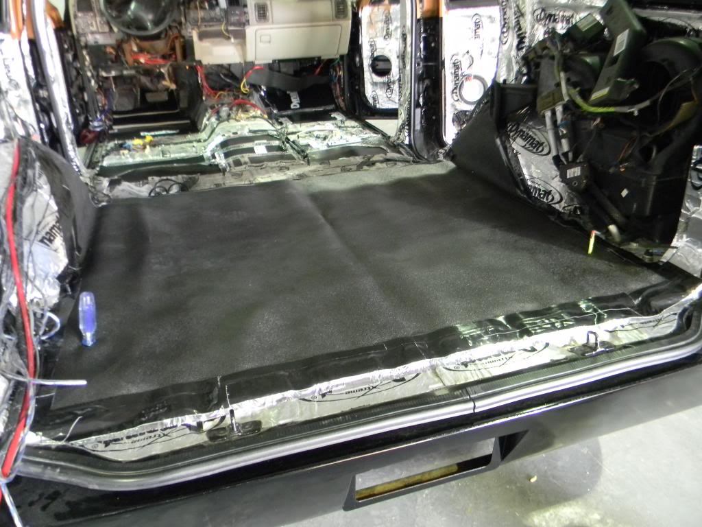

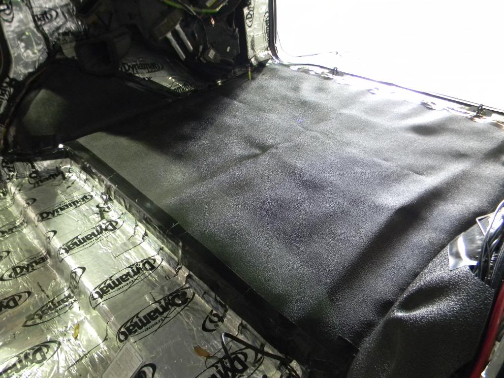

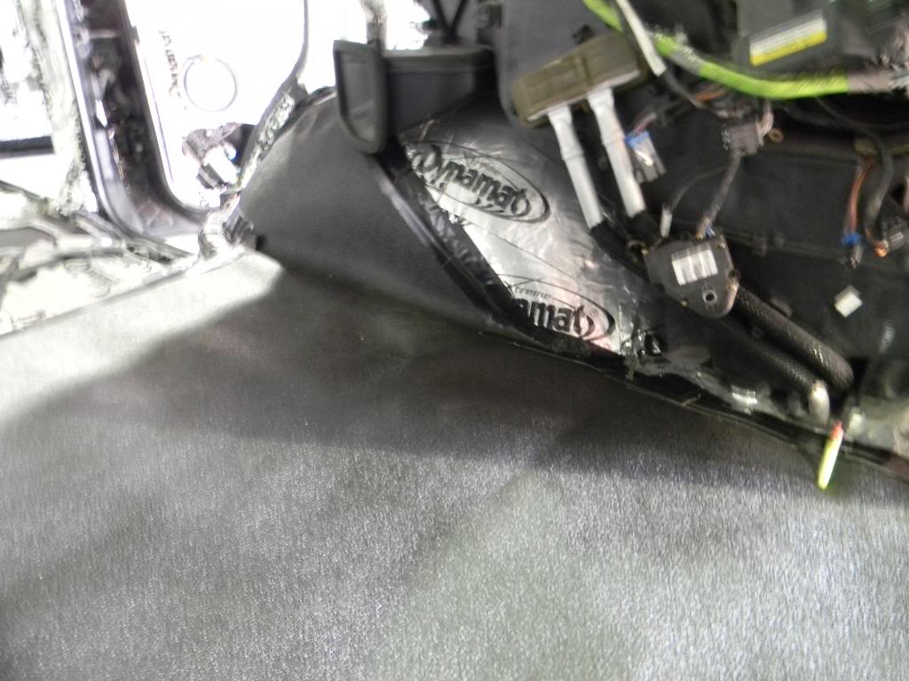

Finished up the 2nd layer in the cargo area, then I cut the rubber sound deadener layer that came with the carpet and locked it in place with some gorilla tape. I’m hoping to cut the passenger rubber and lock it in place over the next couple days.
