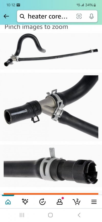

I'll just do oem for the heater core tees for now
Thanks
