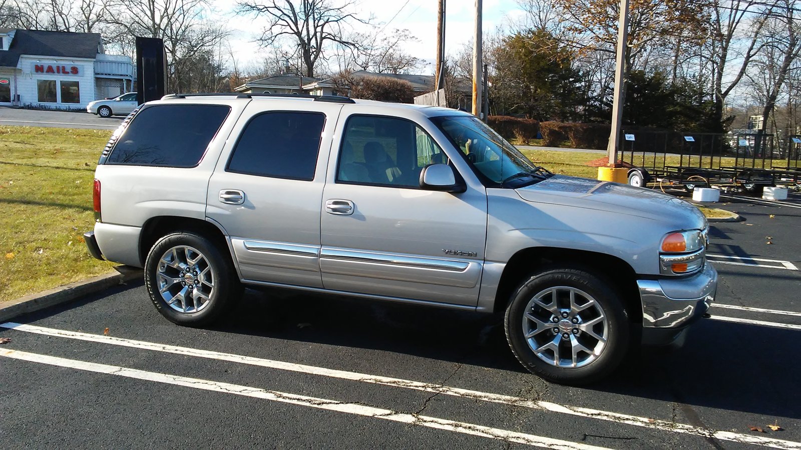

I replaced my autojunk with 5100`s. Some people say you should also replace the springs with Z71 springs. A few guys on here don`t believe me when i say its absolutely fine to run them with regular shocks. I finally remembered to take a picture of my yukon with 800 pounds in the back to prove that they`re up to the task.

I replaced my autojunk with 5100`s. Some people say you should also replace the springs with Z71 springs. A few guys on here don`t believe me when i say its absolutely fine to run them with regular shocks. I finally remembered to take a picture of my yukon with 800 pounds in the back to prove that they`re up to the task. View attachment 188524
Just because you park over by the trailers doesn't mean we don't all know you were over there getting your nails did. Lol.
That sits pretty good imo
