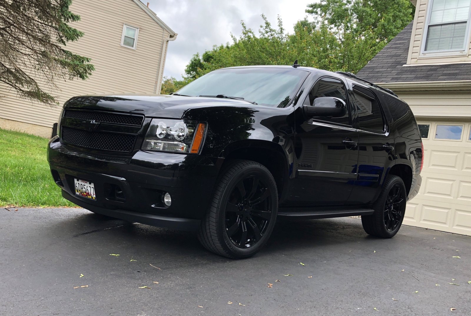

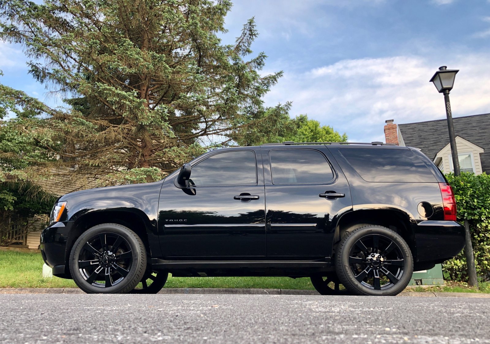

Hi all,
So my Tahoe has 170k miles and has had 3 owners (it has lived well!). Even with new wheels/tires that were Hunter Road Force balanced I have a slight vibration over 70mph that is driving me nuts. It's nothing terrible, but I drive at that speed for 60+ miles a day so it wears on me. So far I can tell:
Front lower ball joints were replaced 50k miles ago
Front sway-bar end-links are blue so they must've been replaced as well
Rear shocks are new (were leaking so I replaced them)
So my question: What are the other commonly worn parts at this mileage? I wanted to get an alignment since I'm pretty sure that's the issue, but just in case it's not I don't want to have to do it twice.
