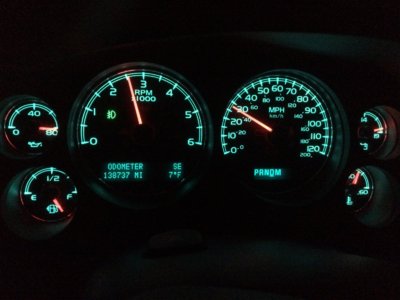

Yesterday morning my gauge cluster went funny. All my gauges were reading way too high and didn't reset when I keyed off. See attached pic. This is with the truck idling with the transmission in park. I had to disconnect the battery for a second to rezero them. Then they were fine.

Gauges were working, though nearly pegged, tach and speedo were tracking, but reading way too high.
No idiot lights, no MIL, nothing. Truck ran perfect, all other electrical/electronic functions were fine.
I asked a GM tech buddy but he hasn't seen this on this generation cluster. His guess was the cluster might be going bad or there was a ground issue. I've only had the truck for four or five months but it has a duralast brand battery of unknown age so I am suspecting that. At this very low temperature maybe the battery is struggling and the voltage issue is pissing off the cluster. The truck seems to be starting ok (though i do remote start it from inside the house this time of year). There is no problem with the cluster the rest of day when the sun comes up and its slightly warmer. Since ALL the gauges did it I don't think a servo is going bad - there is no way they would all go at once.

Not on any gm’s ive owned but one winter my father in laws suzuki aerio did that... as soon as temps warmed up it went back to normal operation. Your truck prob isnt used to the cold, personally, I would deal with it until it warms up.... in a few days...

and just a heads up if the cluster is being screwy it wont affect drivability, you can drive without a cluster all together but it may throw code if it goes completely screwy.

Yeah, it otherwise acted completely normal. No MIL/CEL lit up and I havent done a scan yet. I'm not sure an electronics error would display a code until it started affecting other components.

it wouldn't throw a code unless the cluster was considered unresponsive for a period of time, same as if it was unplugged, the truck will drive fine either way
