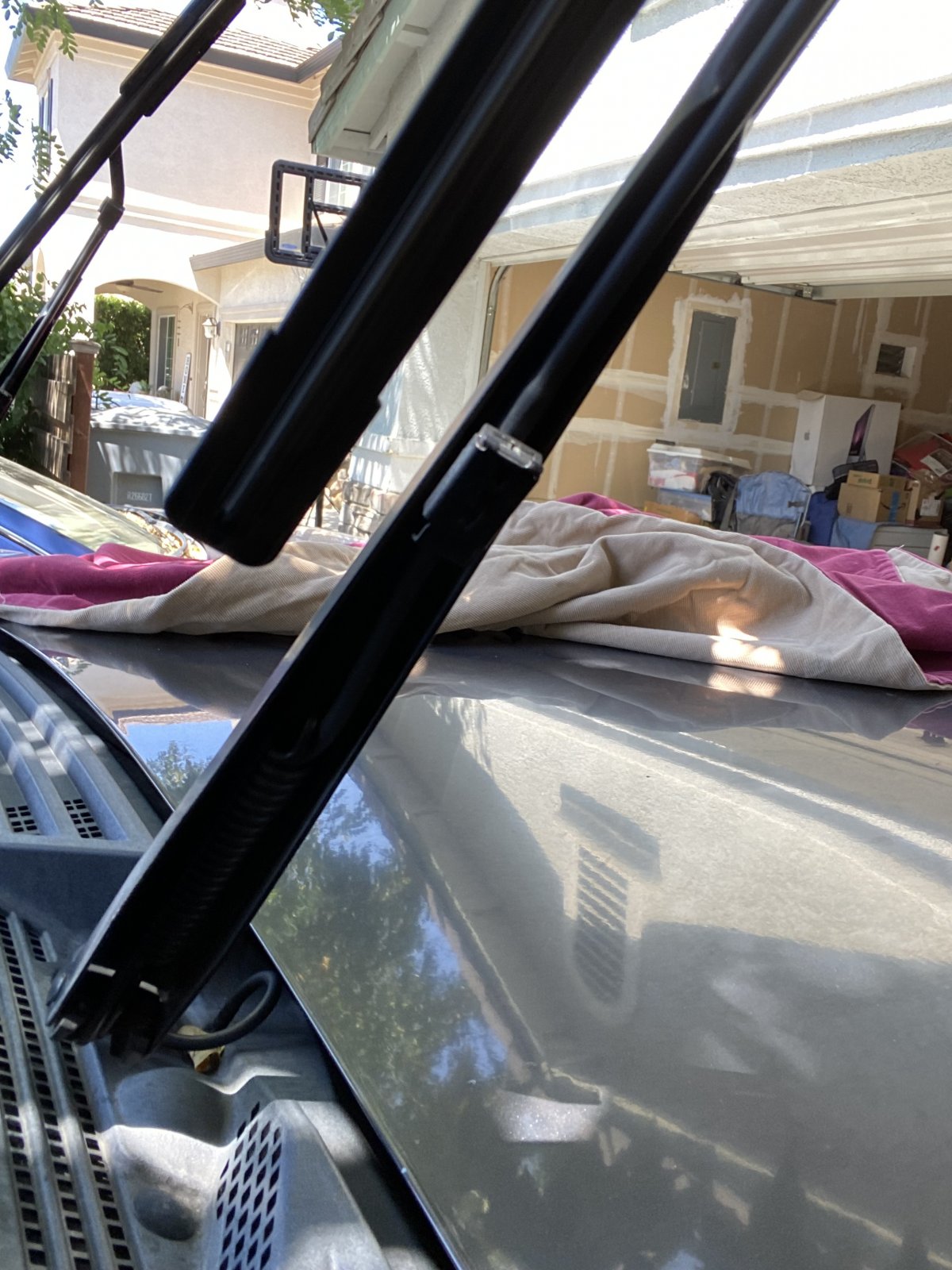

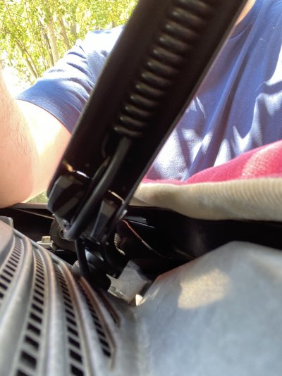

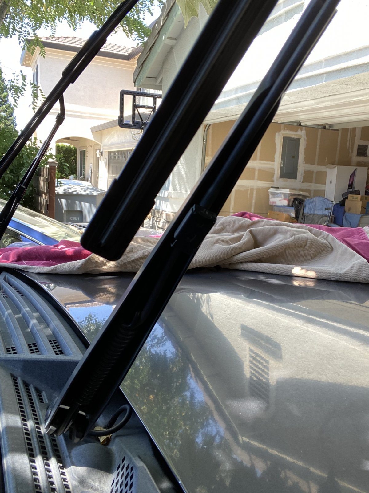

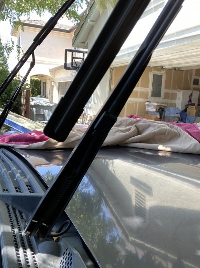

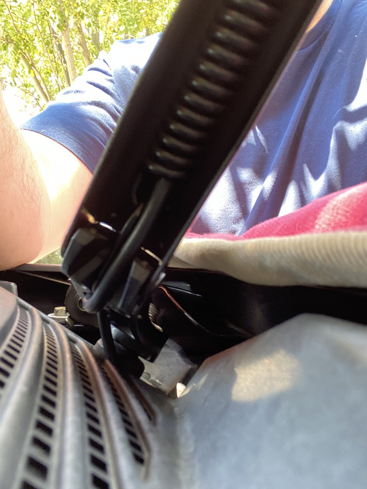

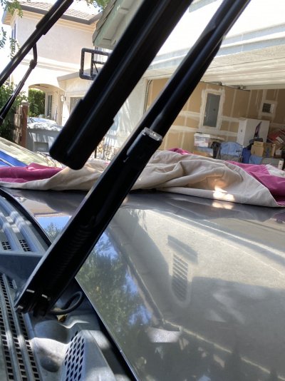

Hi Joseph Garcia.
Yes l. I found the issues. The tube that connects to the wiper blade came loose to the nozzle nipple just below the wiper blade. Then of the two lines one became disconnected and then the real culprit the line itself to the reservoir is not connected. So it’s a 109 degrees
Outside. I’ll check it out later. Your advice was spot on and after some looking around it became obvious lines just came loose. The trick will be getting it altogether and working. Do you recommend electrician tape where the lines are loose. The washer lines are loose and it’s not staying together.
Thank you.
Kenneth

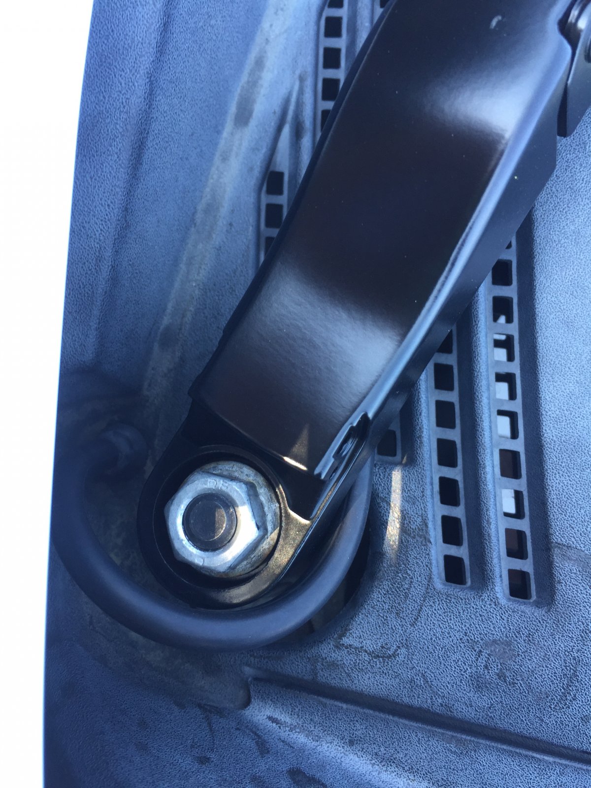

On my truck the hose loops around the outside of the wiper pivot.

Hi Joseph Garcia.
Thank you.
Kenneth
No electrical tape. The hose is old and looses it's grip on the fitting/nozzle it is on, as it gets older and harder and then has less grip. You can get washer fluid hose by the foot at a parts store. Take some needle nose pliers and a pair of cutters of your choice and install new hose. The hoses and the fittings can get clogged up with the crud created by the washer fluid. If you have air, blow them out in both directions. You can also use a thin straight pin to push in the fittings/nozzles. If you do blow the lines out, do not blow INTO the washer pump.
The Grey Beast
The Grey Beast
May 11, 2023
233
168
Great thank you both. Can I ask a favor. There are lots of tools out there. Not sure which ones to get. Could you give the makes you like or link them. What I need for a tubing repair for windshield wipers. I find that I’m lacking in the tool dept. No pun intended.
Thank you.
Ken

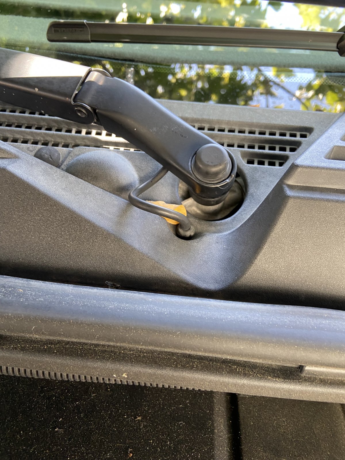

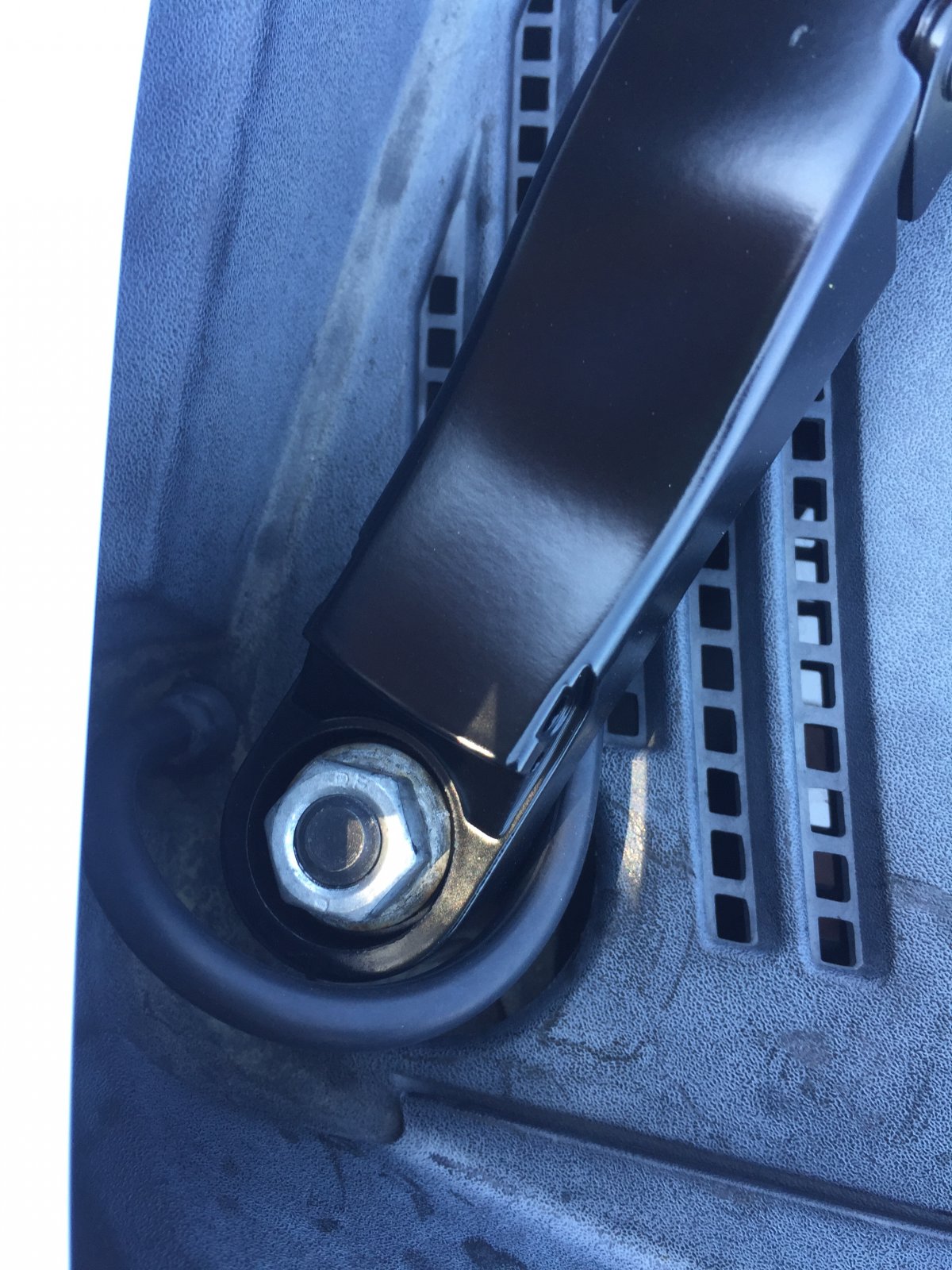

Mikez71
In the pictures does it look like the previous owners changed it or does it look stock? Chevy does change things around. To me it looks stock but you never know.
Ken
mikez71
Mar 9, 2023
3,367
4,166
this is how mine looks..
missing nut cap because i changed to ppv wipers which must use a different cap!

The pics indicate that it is either factory or detailed install. It really isn't hard to duplicate the install procedure and the look afterwards. What @Fless said holds true and can be done sometimes but when I do something like that, it is just to get me to the point where I buy new hose and replace it. The trimmed hose is still old. But then again, I am a thousandaire and like to spend money on my Tahoe.

So the winshield line was blocked by a glue filled T shaped nozzle connection. Chevy fixed it and it works fine.
Thanks to all.
