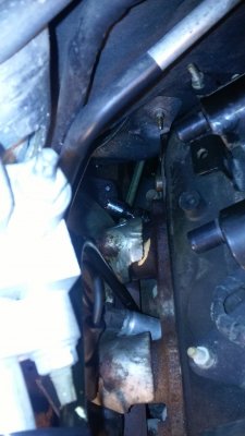

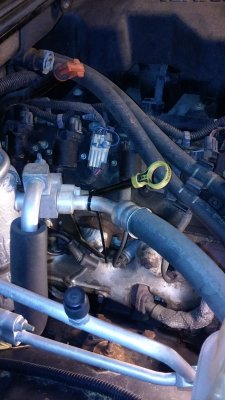

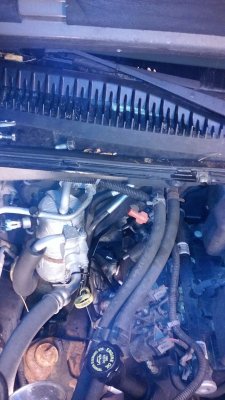

# 8 was not that bad take off the bolt to oil tube and zip tie it to the ac
