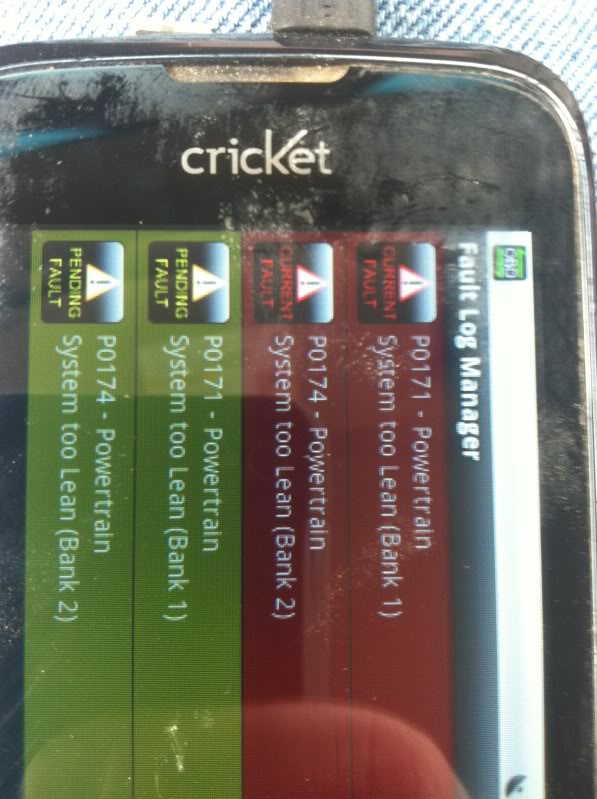

This program has a lot of function I was recently able to determine an intake gasket leak after poor mileage and Codes p0171 and p0174 Lean banks 1 & 2.

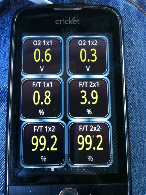

I stood out side the car with the phone and sprayed carb cleaner along the intake runners watching the 2 fuel trims. Found the leak at cylinder one and two.
These are normal levels leak when sprayed is +12-36 as I saw.

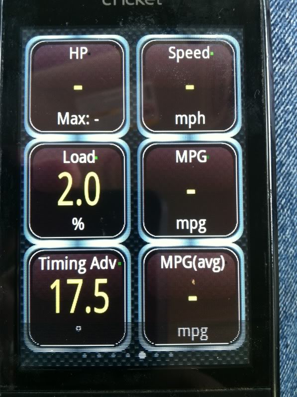

It will also give you a rough estimate (actually pretty close with in .5 MPG on the average) of MPG and Current MPG after you enter your vehicles GVW in kilograms.

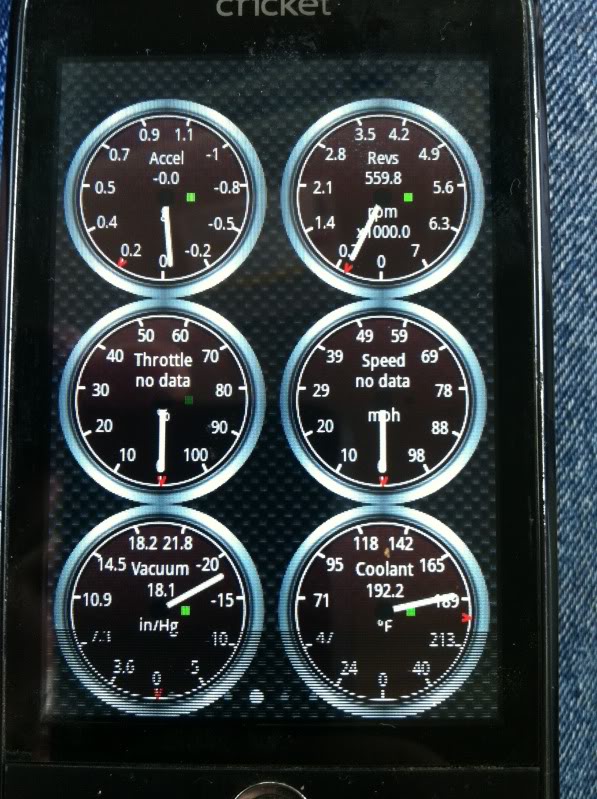

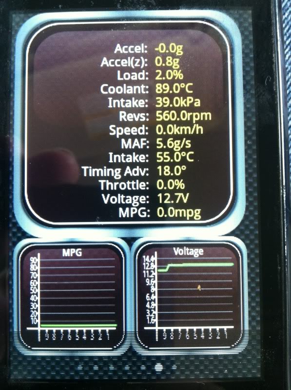

You can get actual speed as the computer sees it and pretty much any sensor available to your computer.
Here is a couple of screens I have setup you can set them up how ever you want.
Here is the codes read out.
