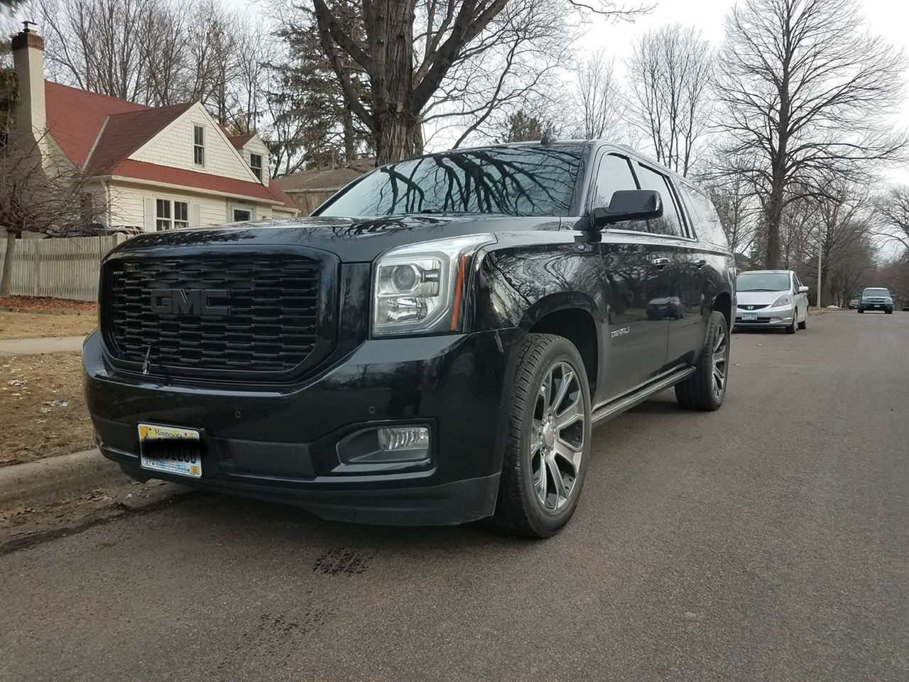

I tried one, but went with the ‘18+ design on the ‘17. Also, plasti-dipped the fog surrounds. Clips are tricky, but I just took the whole thing off in one piece and then used trim removal tools…Still no fun.

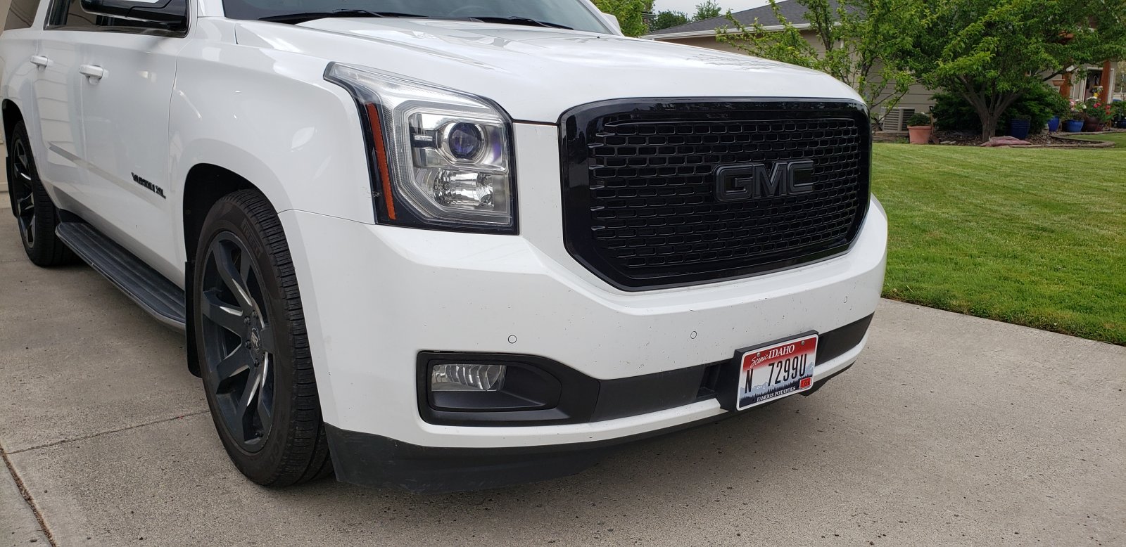

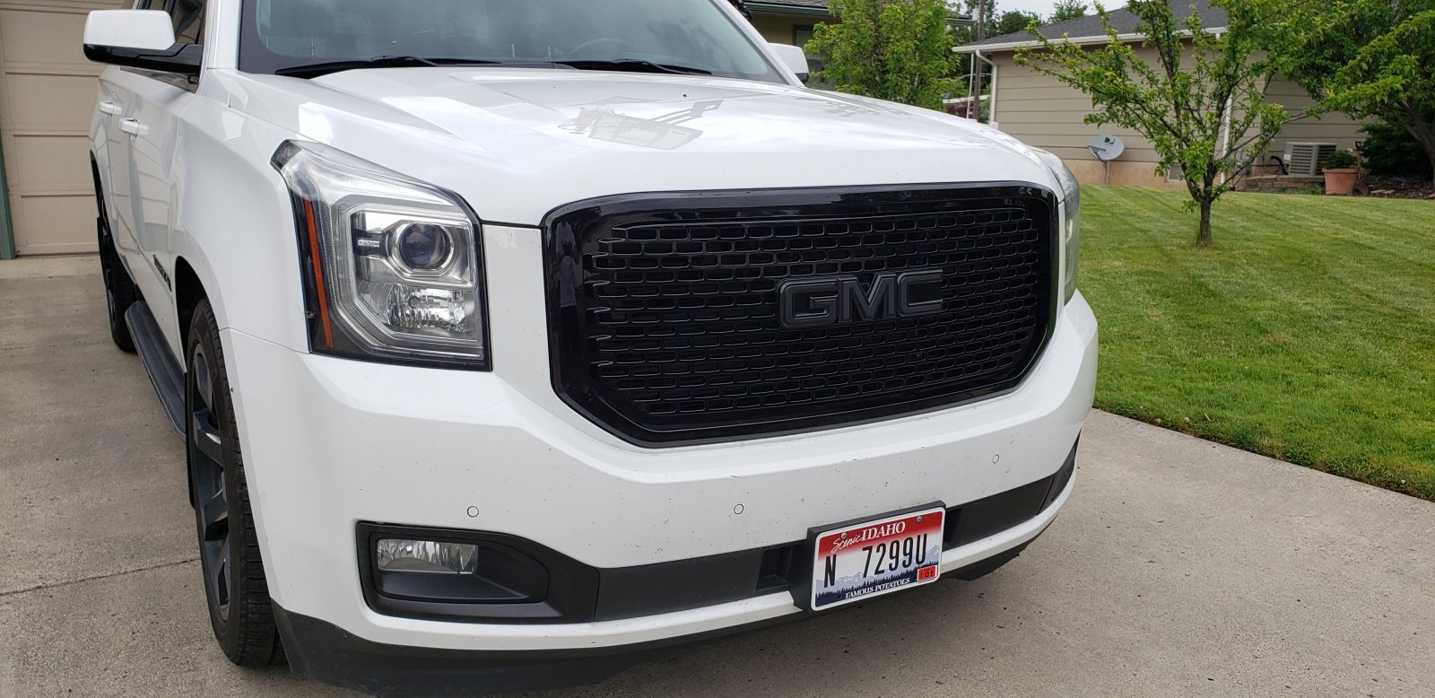

Got the replacement side mount brackets in the mail yesterday and grill re-installed. Overall looks are good, but we'll see how long it lasts as it's definitely cheaper then OEM and the top mounting brackets didn't fit good either. Almost looks like the brackets are about 1/2" lower then the factory ones so you have to bend them a little. Also, the side of the grill doesn't sit tight against the bumper cover like the factory one does. It's hard to see as everything is black, but there is a good 1/8" gap or more.
