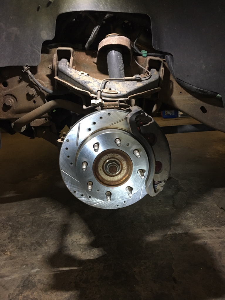

  7. bfourman
    bfourman Full Access Member
    Posts:
    110
    Likes Received:
    204
    Joined:
    Aug 23, 2015
    Location:
    Indiana
    Name:
    Byron
    [​IMG]
    Brakemotive w/ceramic pads. Search eBay, excellent pricing and fast shipping.
    bruce s likes this.
