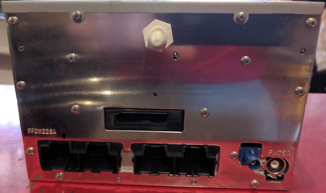

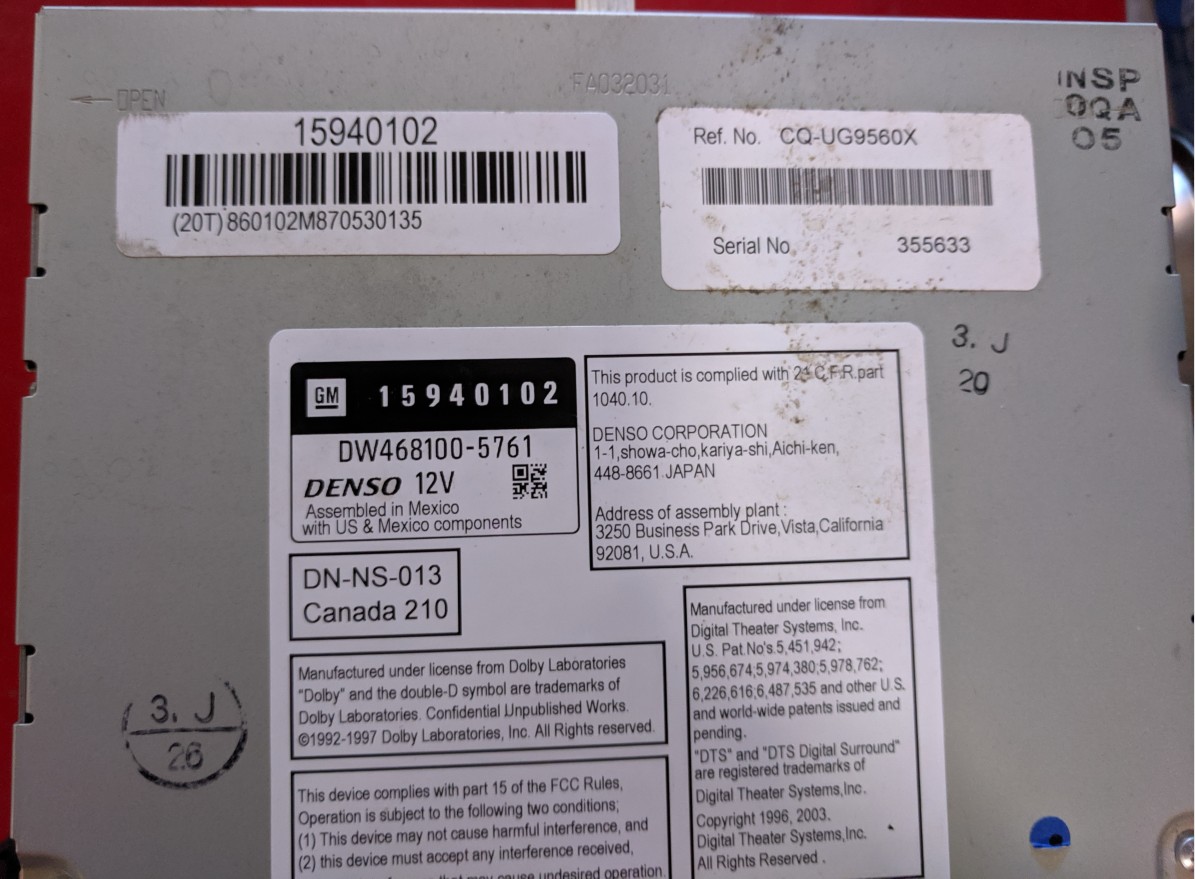

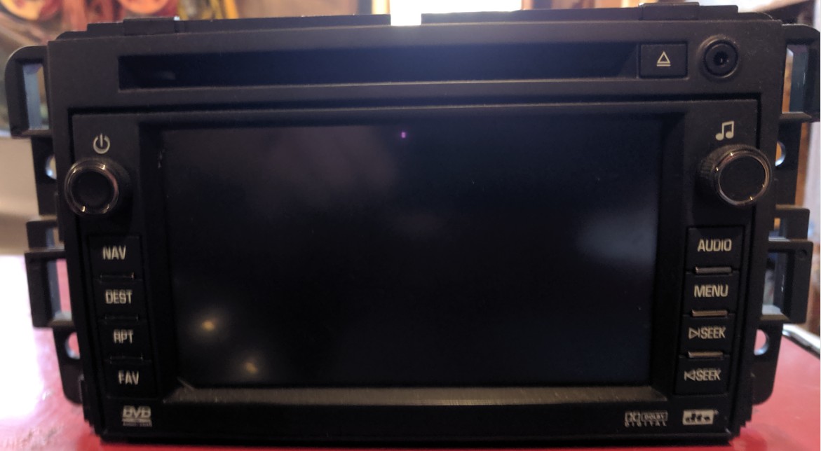

Photos of the Bose head unit that I removed.
