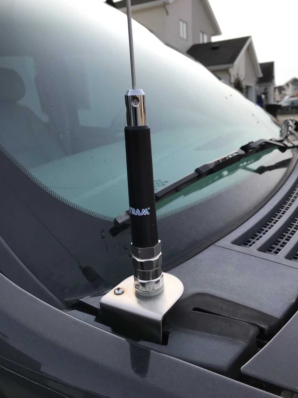

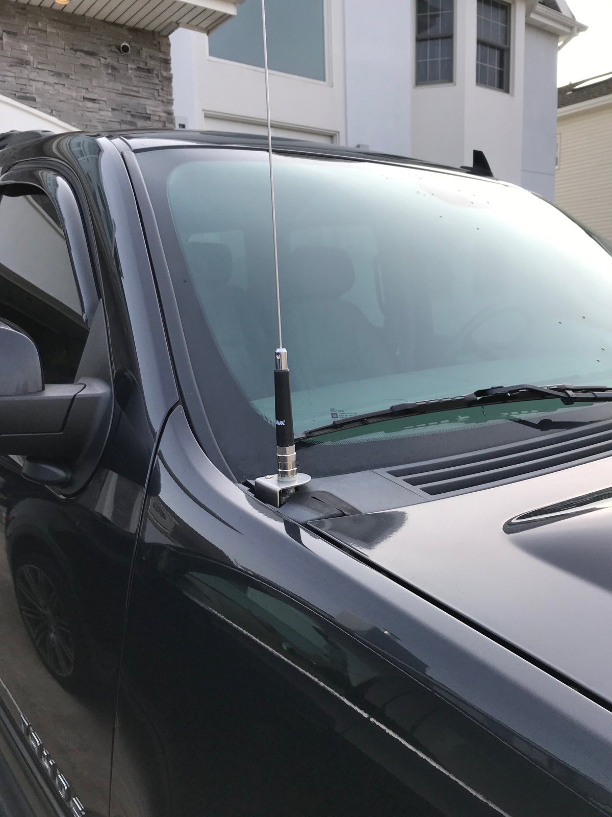

Chrismnj
Sep 17, 2015
1,227
2,121
NJ
Here is mine, hope it helps.
