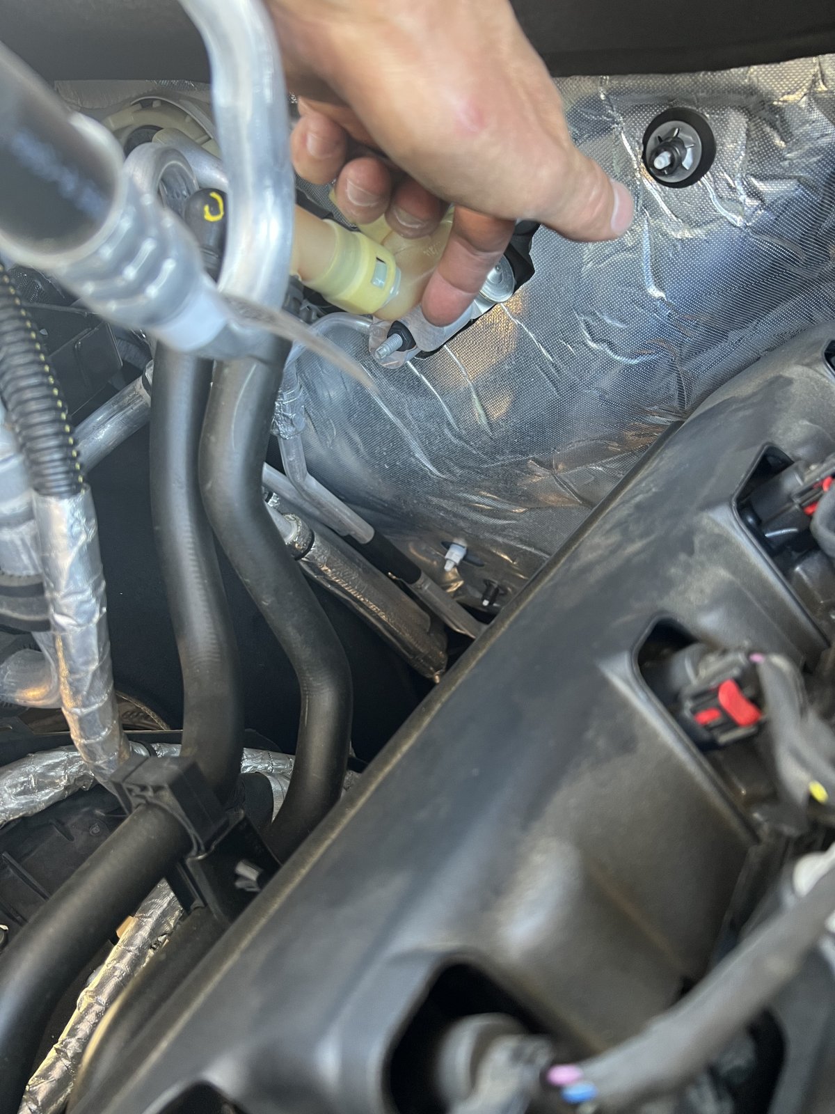

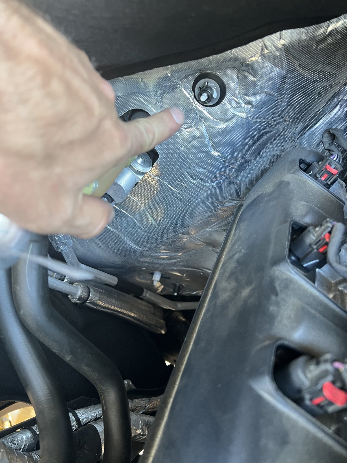

1. Does anyone know the size of this nut (I’m pointing to in the picture)? Can I get that nut at the dealer? I’m looking to mount my catch can off that stud.
2. The other nut I am looking for is smaller see picture below. Anyone know the size of that nut? Or where I can get one for that stud?

I think I will be ok. I found the correct flange nut for the larger stud where the A/C equipment is mounted to the firewall. This could work. There are a couple things that concern me though. There is some play in the stud itself, a small amount, however I got on it with a pretty good amount of force to move it. The bigger issue is that with the mouting bracket + washer + nut I don't feel like there are enough threads coming through. I think it would hold, and I would be fine with it, but I don't need to put the extra stress on it if I don't need to.
I don't know why I didn't think of it this afternoon while I was getting the nut for the above mention stud, I should have also got a M6 10mm nut for the secondary location. I also carefully put some force on this stud with my hand this afternoon and I do feel like it is pretty sturdy. Tomorrow I'll stop by Lowe's again to get a M6 nut. There is another catch can company that uses a similar stud on the silverado but on the driver's side yes with a smaller can. I think I will be ok. The nut size is a little small but I think I'll be ok with a washer. I could do a small dab of lock-site, or I could torque stripe it and monitor. I don't believe the dual catch can would put enough force on the stud to bend it or shear it off. More to follow!

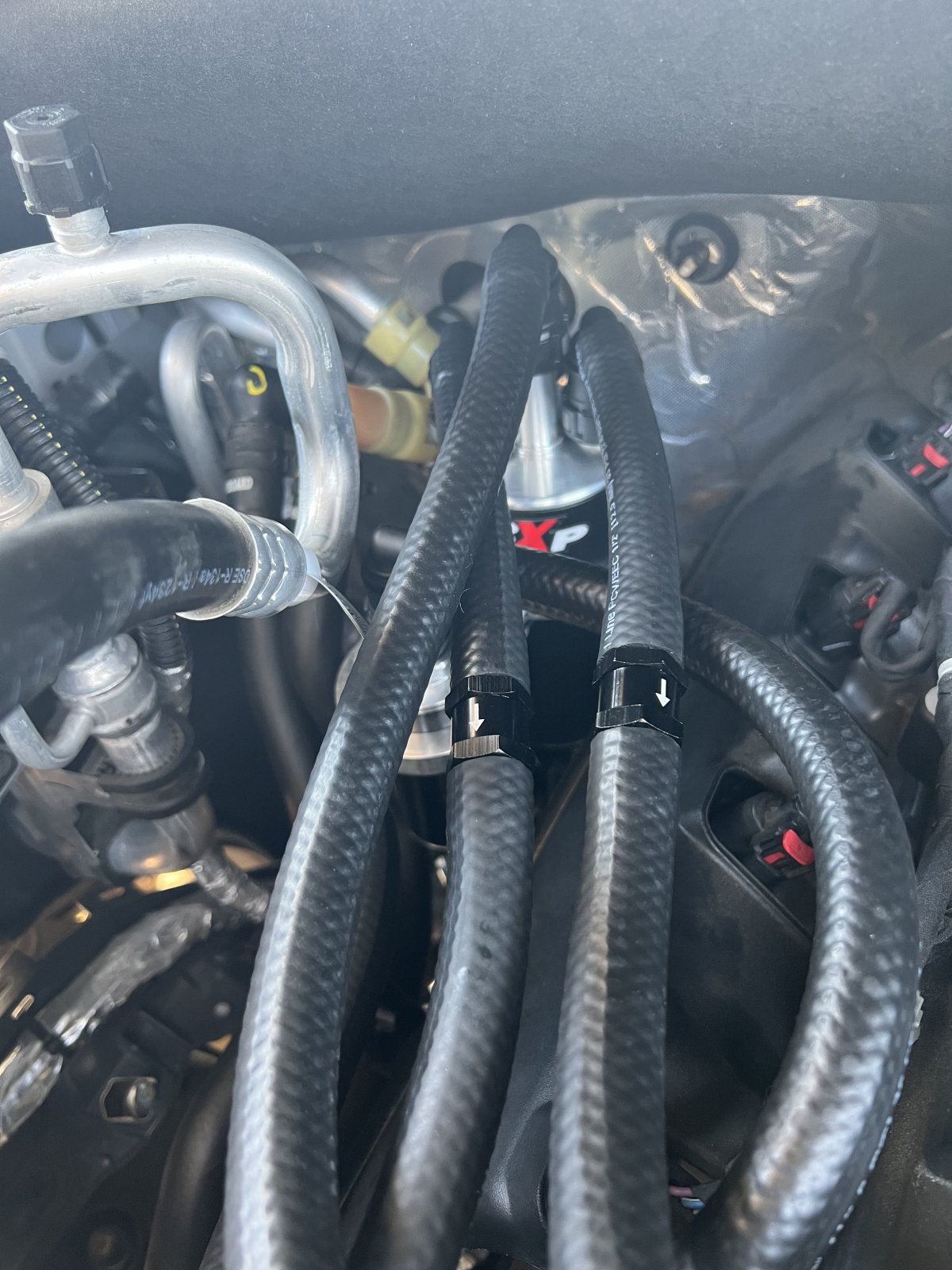

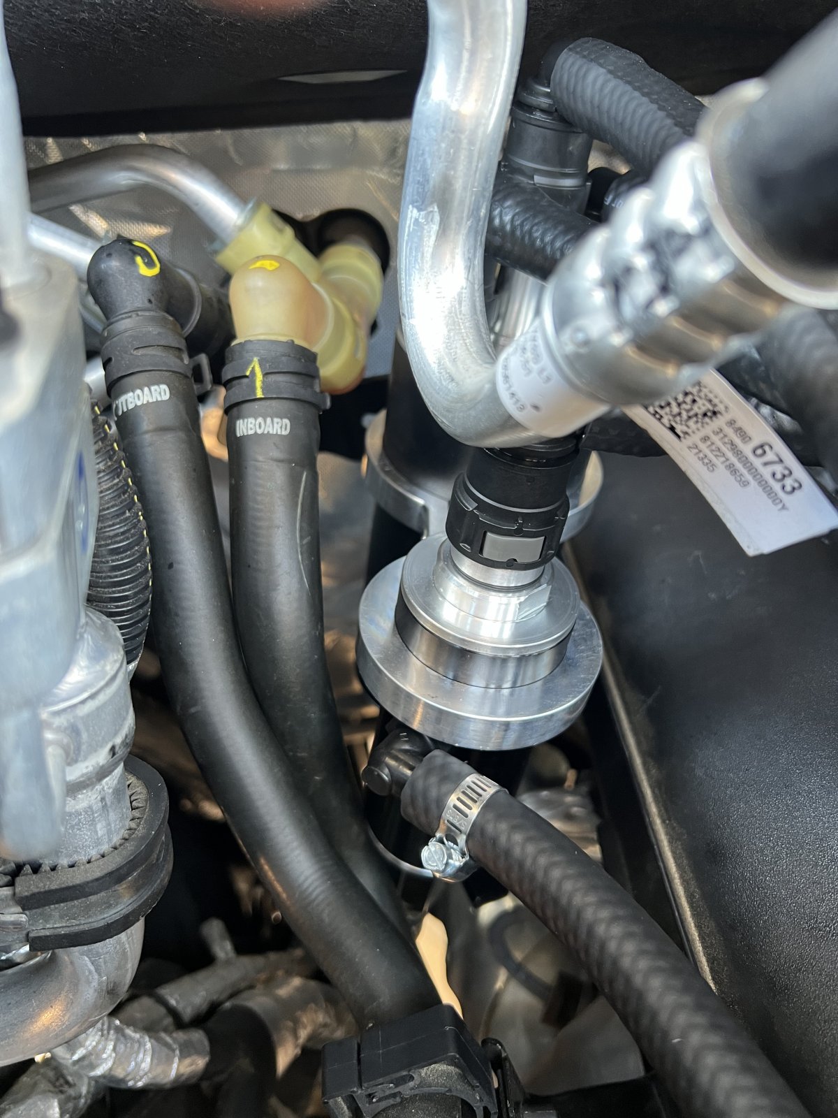

Got it in recently. Seems like a pretty solid fit.
I have a YouTube video of how I ran the lines.

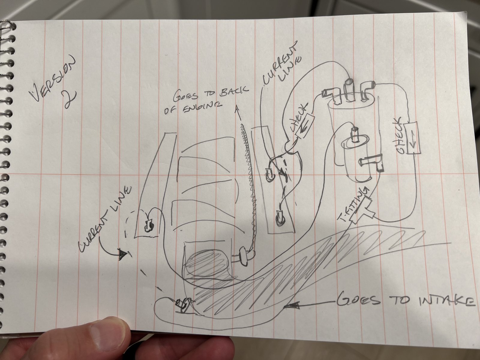

Assessable - yes. Although it is a tight squeeze. I have hoses connected to the drains that run down near the oil pan drain plug for easy draining. Unfortunately there really isn’t a great place to mount this system. If I had a metal shop I could possibly create a better spot. There a couple videos of this system on the Silverado and they have more room. I used a bracket from an old RXP catch can I had on my Camaro that just happened to work out.
It is a dual can system and rather large that’s why there are a few connections. You get suction off both valve covers and the intake with this. Over the years RXP has improved their design. They started out with only a single can system.

I have the RXP single can on my Camaro. I watched the video of the new dual can setup. Seems to make sense. I was noticing people on youtube with other cans are just picking up one side of the valve cover and not the intake hose.
