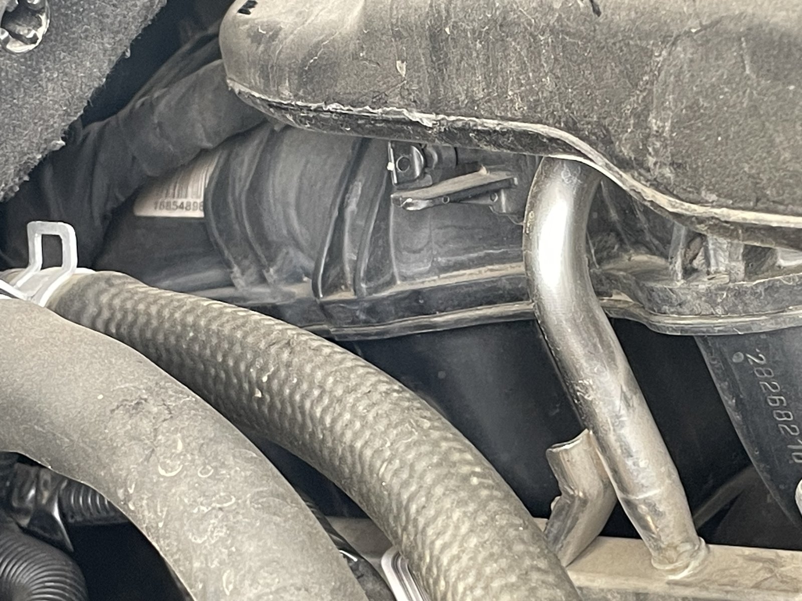

Can someone identify this for me please
Rueger
Oct 6, 2015
Recent valve cover replacement. P0174 shortly after. Part is sucking air

Looks like the same as this one that wasn't too long ago. It’s déjà vu all over again.
R
Rueger
Oct 6, 2015
Déjà vu indeed. Don’t know what it’s called but I plugged it off cleared the codes and it hasn’t come back. Good eye and thanks for post

If it was open, u definitely would have heard air.

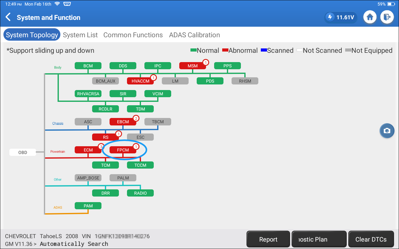

I'm confused... The vacuum connection on that intake was found on the 1999-2006 Gen III Vortec for a vacuum operated fuel pressure regulator. But the fuel rail in the image is the Gen IV return-less fuel system without a regulator on it. Instead of using vacuum to control a pressure regulator, Gen IV is managed electronically by the FPC module.
In other words, it looks like a Gen III intake on a Gen IV Vortec.
Or maybe I'm losing my mind... :)

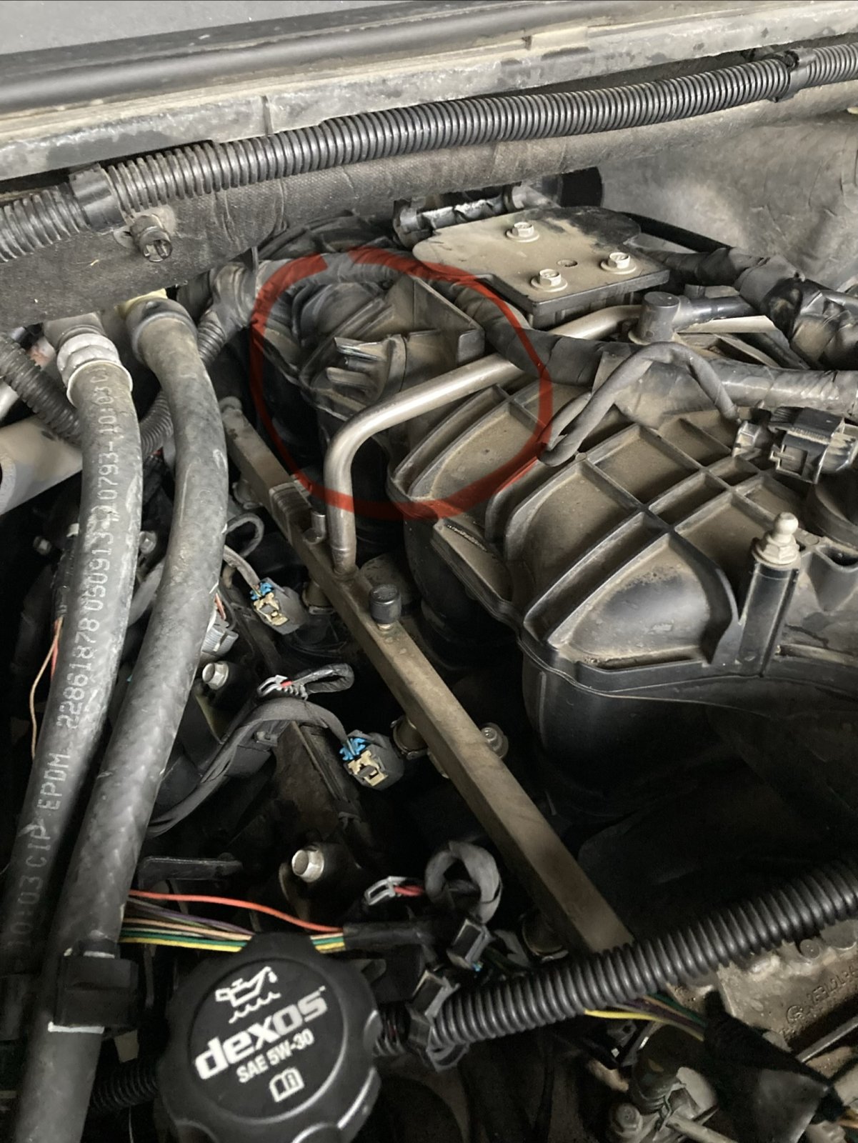

Genuine IV intake manifold does have a vacuum nipple on the passenger side of the intake, capped off from the factory. Not aware that it was used on any model.
The Gen III vacuum port for the mechanical fuel pressure regulator was on the top of the manifold, with the regulator being mounted on the driver side of the fuel rail. (LQ4 for example)
07 has a regulator on the FP module in the tank. No FPCM.
Interesting! Had to go check our GMT900 Tahoes. I could have sworn they didn't have the port. Well, as it turns out, our 2013 LTZ has it (factory plugged), but our 2008 Z71 does not have it. I know both intakes are original since we bought both of these Tahoes new. In fact, ordered them from a dealer local to the plant in Arlington with less than 10 miles on them. Maybe they just grabbed whatever intake was available :)

Forgot I took a picture of mine because of this thread.. Just to see what the cap? looks like.. 2012 model.

Here's a 2014 model with the vacuum port plugged off OEM.
A little late to the ball game on the picture... Just happening to do an oil change, front and rear differential oil change, complete transmission fluid and both filter changes (been 32,000 miles). I do have a secondary transmission filter in line, which is a spin on hydraulic filter. And I just remembered this post :cool:
