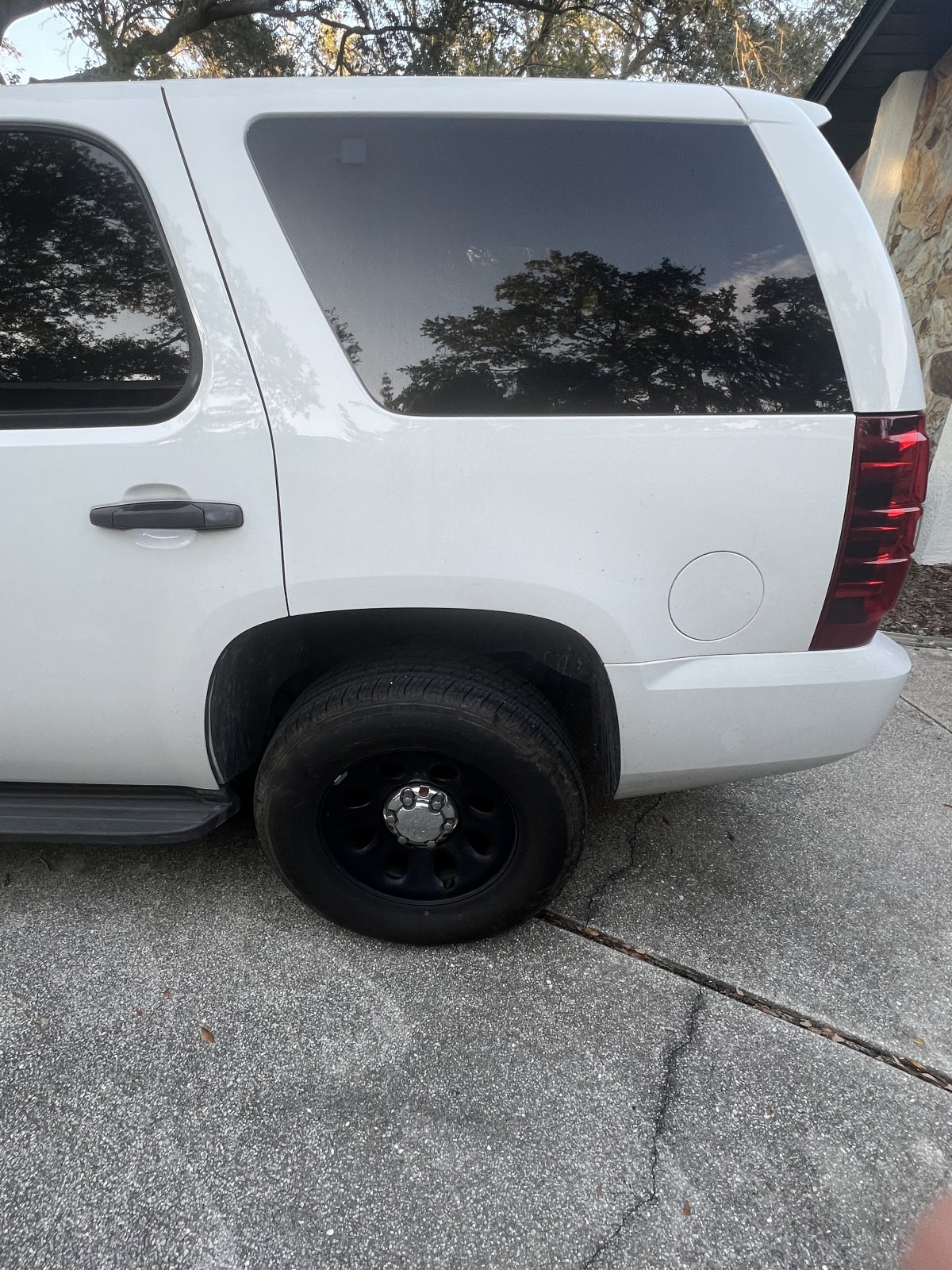

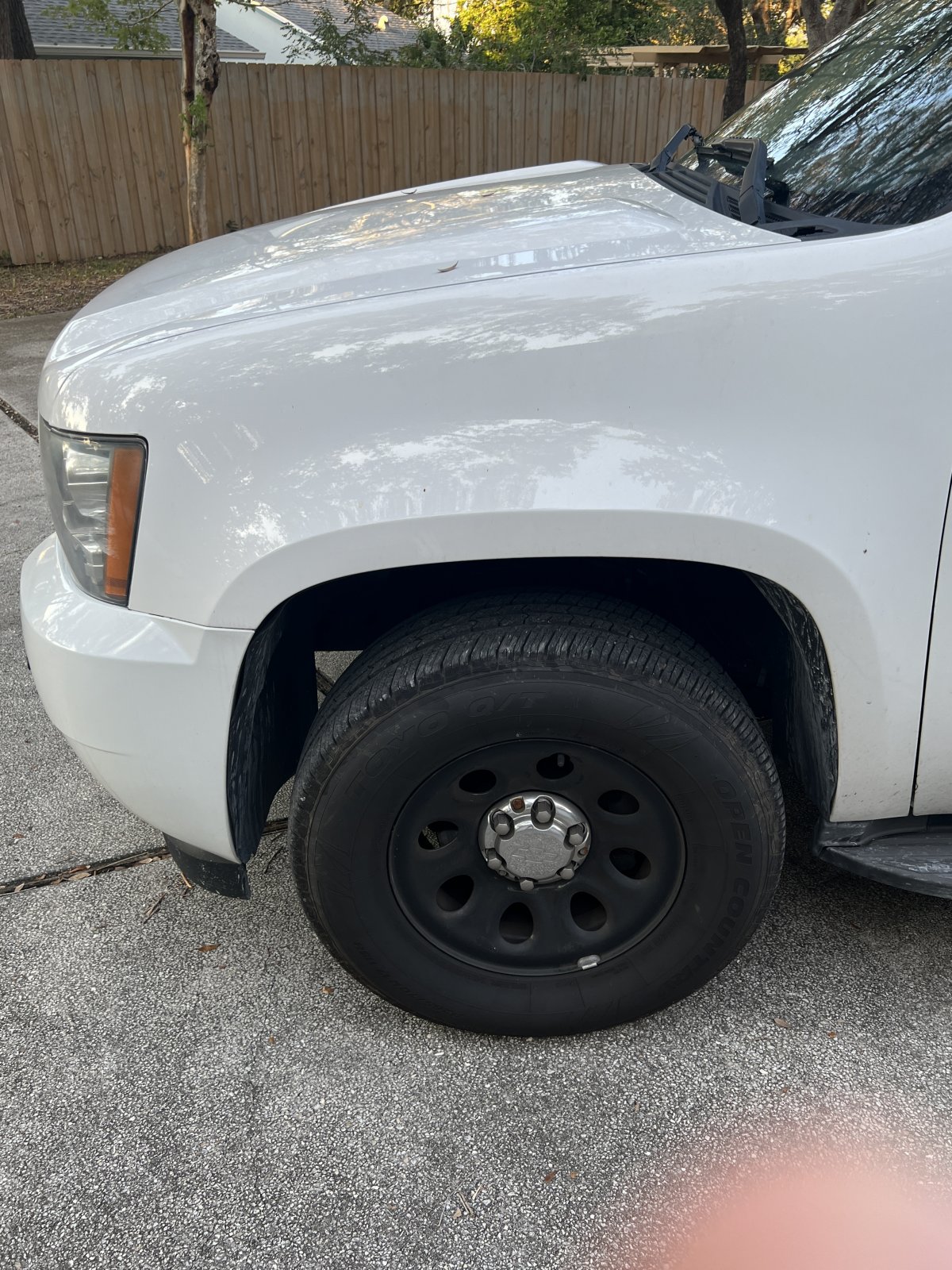

We just got a 2014 PPV but it rides very harsh, feeling every bump. Has anyone found a solution? Thanks in advance!

I also read the PPV tires can be replaced with something less aggressive than the Goodyear eagles that are installed currently. Any recommendation for the softest riding tires that will fit these PPV steel wheels?

I just figured and read that less aggressive/not high performance eagle tires would significantly improve ride comfort. I’m not planning to zoom around on a track. Just driving around town and highways. Hope that makes sense.

Go with a much taller sidewall. Tires will be cheaper, you don't need speed rated. My specs are in my sig below, and I've got 60k+ miles on that suspension and tire size with no regrets. Made a world of difference.
Actually, until you get rid of those PPV tires.....you aren't going to improve much on the ride quality, even with suspension. It'll be better with just suspension, but night and day when you do both tires and suspension.
