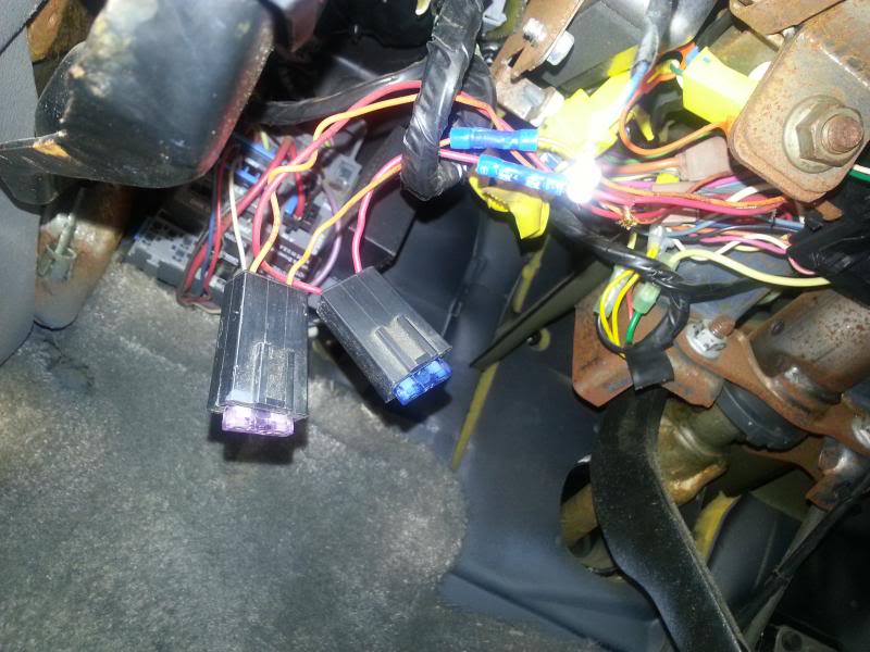

can anyone tell me what these 2 wires are for

can anyone tell me what the two black things with the fuses in them go to?

I don't think that's factory. Looks like someone spliced those in later.

Definitely aftermarket. Does it have aftermarket fogs/driving lights? May have been a CB, etc. Doesn't appear to have been related to a sound system though, since the wires look to be 16 or 18 guage

Only thing it has is a kill switch I need to hold in so I can start my truck.other then that nothing that I can see.

i found out what those wires went to.they where spliced into two wires on my harness.(a thick red wire and a thick orange wire)and they went to a after market sunroof that didn't work.

I disconnected them from the harness..do you happen to know what the wires tbey where connected to are.it is a thick orange wire and a thick red wire on my harness under th dash.

That's where my aftermarket power sunroof was wired to and since i purchased truck it never worked.I also have a parasitic drain I could not find.could that cause a drain on battery when engine is off.

You need to remove each in cab fuse one at a time to locate the draw then proceed to the mini's under the hood then the ****'s after that until you find it.
