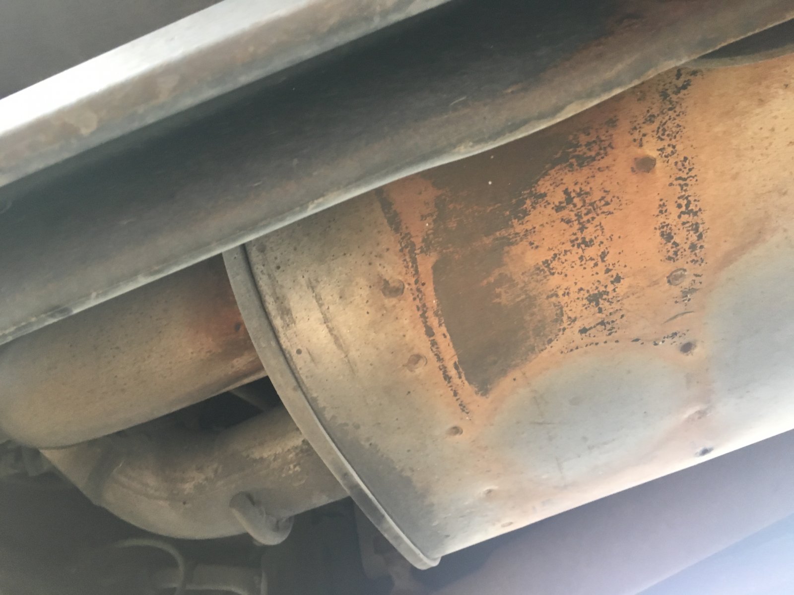

When shopping for a muffler can anyone confirm where the inlet/outlet’s are placed?
I was told center inlet and offset outlet and I was also told single in and out but I just looked underneath the truck and it looks like it had a dual out.
I ordered this. Can anyone tell me if it will work for my 2004 Tahoe z71

The out is really just preference. Some like single out, some like dual out. Unless you have enough pressure where that matters. The problem you are going to have is: That's a really small muffler for this vehicle. That muffler is about half the length its supposed to be for the right muffler. Your out will definitely fit, because there is usually more of the muffler where you are going to put the pipe. You just bought a muffler for a ricer and are putting it behind a V8. My guess is this will be LOUD and DRONEY.
If you are going to try it, My suggestion is use clamps and try it out before you spend time or money welding that on. Get an idea of how it will be. I'm trying to help you waste $90 instead of two to three hundred. Unless you can still return it.

definitely not a muffler for a ricer lol. I put that on my 08 tahoe and my dad currently has the same one on his 16 silverado and both sounded/sound amazing and zero drone.
as far as the inlet/outlet placement it is really just preference. any good exhaust shop will be able to swap your muffler with that one. me personally tho I always look under the vehicle and match what I have to make the swap easier.

You’ll have to excuse my lack of knowledge but if I get a single outlet out does that mean the shop can’t make custom piping to run two tips out of each side (dual exhaust)
I’m confused because the stock setup has a dual out then why is it only ran out one side?
Is there a benefit of dual out the muffler but the piping coming out of one side over a single out and piping still coming out of one side

Any good exhaust shop “should” be able to run a single out to both sides. Key word should. As far as why gm did the exhaust that way or if there is a benefit between the two. I have no idea. But just because it’s a dual out doesn’t mean It has to exit on both sides.
